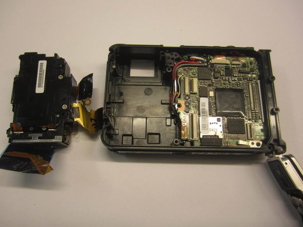

  5. Olympus Stylus Tough-8010 Motherboard/Flash Component Replacement: crwdns2935265:05crwdnd2935265:01crwdnd2935265:03crwdne2935265:0 Olympus Stylus Tough-8010 Motherboard/Flash Component Replacement: crwdns2935265:05crwdnd2935265:02crwdnd2935265:03crwdne2935265:0 Olympus Stylus Tough-8010 Motherboard/Flash Component Replacement: crwdns2935265:05crwdnd2935265:03crwdnd2935265:03crwdne2935265:0
    • Remove four screws (9.4mm) on the front of the camera using a Phillips #000
    • Use the plastic opening tool to release the holding clip.
    • Using tweezers separate the plastic strips from their connectors located on the main circuit board by lifting the small, black flaps on the connectors and pulling on the ribbons.
  6. Olympus Stylus Tough-8010 Motherboard/Flash Component Replacement, Lens: crwdns2935265:06crwdnd2935265:01crwdnd2935265:02crwdne2935265:0 Olympus Stylus Tough-8010 Motherboard/Flash Component Replacement, Lens: crwdns2935265:06crwdnd2935265:02crwdnd2935265:02crwdne2935265:0
    • Remove any tape on the flash component on the left.
    • Using tweezers, disconnect the plastic strip from its connector on the motherboard by lifting the plastic black flap on the connector and pulling the ribbon.
    • Using a #000 Philips head screwdriver remove four screws (4.1mm) on the metal plate.
    • Gently lift the flash components out of the camera casing.

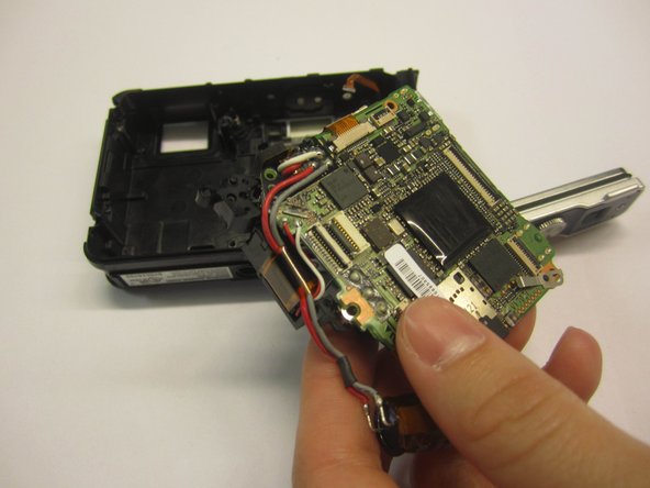

  7. Olympus Stylus Tough-8010 Motherboard/Flash Component Replacement, Motherboard/Flash Component: crwdns2935265:07crwdnd2935265:01crwdnd2935265:03crwdne2935265:0 Olympus Stylus Tough-8010 Motherboard/Flash Component Replacement, Motherboard/Flash Component: crwdns2935265:07crwdnd2935265:02crwdnd2935265:03crwdne2935265:0 Olympus Stylus Tough-8010 Motherboard/Flash Component Replacement, Motherboard/Flash Component: crwdns2935265:07crwdnd2935265:03crwdnd2935265:03crwdne2935265:0
    • Remove the three screws (7.9mm) connected to the motherboard with a #000 Phillips head screwdriver.
    • Using tweezers disconnect the plastic strip in the top right corner of the motherboard with tweezers by lifting the small plastic flap and then pulling the ribbon from its connecter.
    • Remove the motherboard/lens component.
