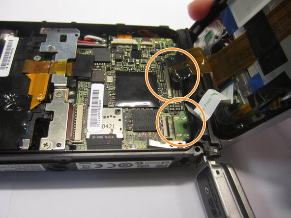

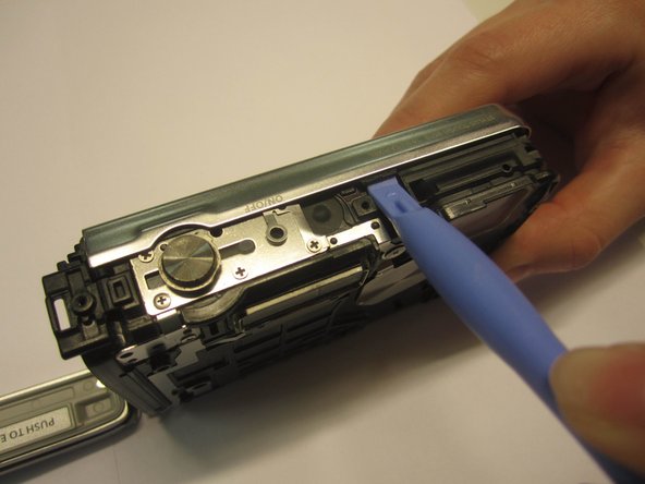

  5. Olympus Stylus Tough-8010 LCD Screen Component Replacement: crwdns2935265:05crwdnd2935265:01crwdnd2935265:03crwdne2935265:0 Olympus Stylus Tough-8010 LCD Screen Component Replacement: crwdns2935265:05crwdnd2935265:02crwdnd2935265:03crwdne2935265:0 Olympus Stylus Tough-8010 LCD Screen Component Replacement: crwdns2935265:05crwdnd2935265:03crwdnd2935265:03crwdne2935265:0
    • Remove four screws (9.4mm) on the front of the camera using a Phillips #000
    • Use the plastic opening tool to release the holding clip.
    • Using tweezers separate the plastic strips from their connectors located on the main circuit board by lifting the small, black flaps on the connectors and pulling on the ribbons.

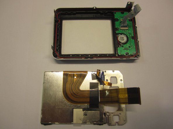

  6. Olympus Stylus Tough-8010 LCD Screen Component Replacement, LCD Screen Component: crwdns2935265:06crwdnd2935265:01crwdnd2935265:01crwdne2935265:0
    • Remove all the tape and clear rubber material from the components.
    • Remove two screws (4.1mm) using a #000 Phillips head screwdriver on the left side of the lcd component.
    • Make sure to set aside the two metal pieces that come off after the screws are removed.
    • Using the tweezers disconnect the plastic ribbon from the connector on the control board by lifting the small black flap on the connector and pulling on the ribbon.
  7. Olympus Stylus Tough-8010 LCD Screen Component Replacement: crwdns2935265:07crwdnd2935265:01crwdnd2935265:02crwdne2935265:0 Olympus Stylus Tough-8010 LCD Screen Component Replacement: crwdns2935265:07crwdnd2935265:02crwdnd2935265:02crwdne2935265:0
    • Remove all seven screws (4.1mm) from the metal plates (#000)
    • Carefully lift out the lcd screen component from the camera casing.
