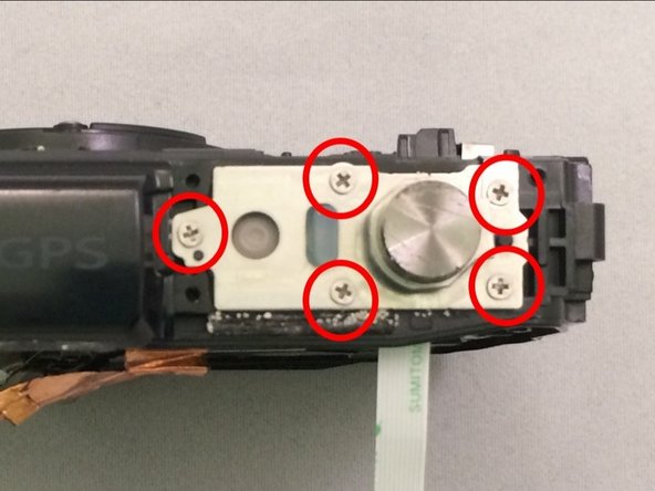

  14. Olympus Stylus Tough TG-2 iHS Shutter/Power Button Replacement, Shutter/Power Button: crwdns2935265:014crwdnd2935265:01crwdnd2935265:03crwdne2935265:0 Olympus Stylus Tough TG-2 iHS Shutter/Power Button Replacement, Shutter/Power Button: crwdns2935265:014crwdnd2935265:02crwdnd2935265:03crwdne2935265:0 Olympus Stylus Tough TG-2 iHS Shutter/Power Button Replacement, Shutter/Power Button: crwdns2935265:014crwdnd2935265:03crwdnd2935265:03crwdne2935265:0
    • Remove the 2 Phillips (size) screws from the plastic housing surrounding the shutter button
    • Using your fingers gently remove the plastic piece covering the shutter and power button.
    • The shutter, power and the orange light cover are now loose.

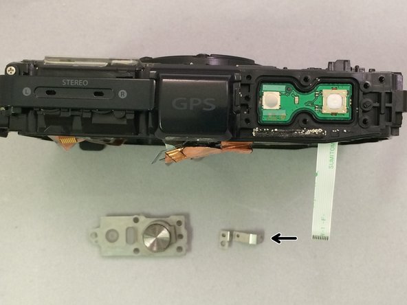

  15. Olympus Stylus Tough TG-2 iHS Shutter/Power Button Replacement: crwdns2935265:015crwdnd2935265:01crwdnd2935265:03crwdne2935265:0 Olympus Stylus Tough TG-2 iHS Shutter/Power Button Replacement: crwdns2935265:015crwdnd2935265:02crwdnd2935265:03crwdne2935265:0 Olympus Stylus Tough TG-2 iHS Shutter/Power Button Replacement: crwdns2935265:015crwdnd2935265:03crwdnd2935265:03crwdne2935265:0
    • Gently pull up on the power and orange button to remove them.
    • Remove the 5 Phillips #00 screws surrounding the shutter button.
    • Remove the protective plate and the rubber portion below it.
    • When removing the small metal plate resting on top of the protective plate that extends down the face of the camera, take note of the orientation.

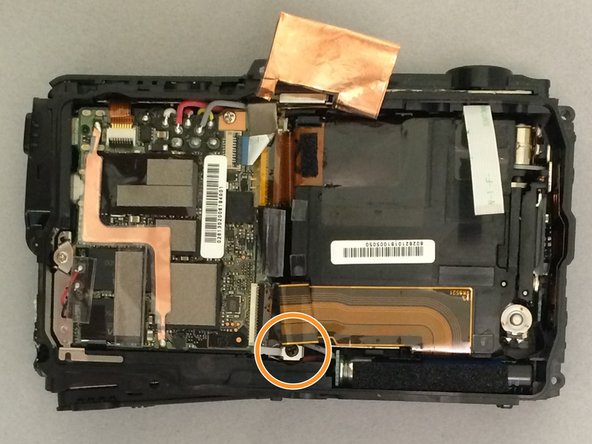

  16. Olympus Stylus Tough TG-2 iHS Shutter/Power Button Replacement: crwdns2935265:016crwdnd2935265:01crwdnd2935265:02crwdne2935265:0 Olympus Stylus Tough TG-2 iHS Shutter/Power Button Replacement: crwdns2935265:016crwdnd2935265:02crwdnd2935265:02crwdne2935265:0
    • Place the camera lens side down.
    • Locate the center of the lens housing and disconnect the 2 largest ribbon cables by lifting the small flaps with your finger.
    • Remove the Phillips #00 screw and the silver metal tensioner below the screw. Remove the Phillips screw (size) next to the ribbon cable.
  17. Olympus Stylus Tough TG-2 iHS Shutter/Power Button Replacement: crwdns2935265:017crwdnd2935265:01crwdnd2935265:01crwdne2935265:0
    • Use the spudger to gently lift the ribbon cable from its holding clip.
    • With your fingers pull back the copper covering.

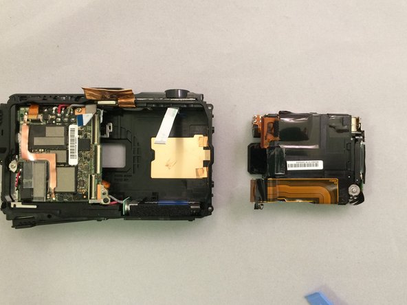

  18. Olympus Stylus Tough TG-2 iHS Shutter/Power Button Replacement: crwdns2935265:018crwdnd2935265:01crwdnd2935265:02crwdne2935265:0 Olympus Stylus Tough TG-2 iHS Shutter/Power Button Replacement: crwdns2935265:018crwdnd2935265:02crwdnd2935265:02crwdne2935265:0
    • Using the plastic prying tool, pry the lens box from the camera.
    • To avoid damage, only pry against the metal covers when removing the lens box.
  19. Olympus Stylus Tough TG-2 iHS Shutter/Power Button Replacement: crwdns2935265:019crwdnd2935265:01crwdnd2935265:02crwdne2935265:0 Olympus Stylus Tough TG-2 iHS Shutter/Power Button Replacement: crwdns2935265:019crwdnd2935265:02crwdnd2935265:02crwdne2935265:0

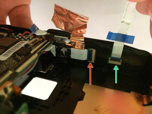

    • Rotate the camera to see the inside bottom of the shutter housing. You will see 2 ribbon cables.
    • At the base of the long ribbon, remove the blue tape and use the spudger to flip its clasp lifting it out.
    • At the base of the short ribbon, use the spudger to flip its clasp lifting it out.
    • Using your fingers or spudger, you may now remove the shutter board.
