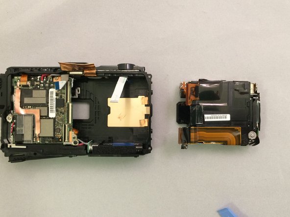

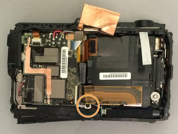

  14. Olympus Stylus Tough TG-2 iHS Lens Assembly Replacement, Lens Assembly: crwdns2935265:014crwdnd2935265:01crwdnd2935265:02crwdne2935265:0 Olympus Stylus Tough TG-2 iHS Lens Assembly Replacement, Lens Assembly: crwdns2935265:014crwdnd2935265:02crwdnd2935265:02crwdne2935265:0
    • Locate the center of the lens housing and disconnect the 2 largest ribbon cables by lifting the small flaps with your finger.
    • Remove the Phillips #00 screw and the silver metal tensionerbelow the screw.
  15. Olympus Stylus Tough TG-2 iHS Lens Assembly Replacement: crwdns2935265:015crwdnd2935265:01crwdnd2935265:01crwdne2935265:0
    • Use the spudger to gently lift the ribbon cable from its holding clip.
    • With your fingers pull back the copper covering.
  16. Olympus Stylus Tough TG-2 iHS Lens Assembly Replacement: crwdns2935265:016crwdnd2935265:01crwdnd2935265:02crwdne2935265:0 Olympus Stylus Tough TG-2 iHS Lens Assembly Replacement: crwdns2935265:016crwdnd2935265:02crwdnd2935265:02crwdne2935265:0
    • Using the plastic prying tool, pry the lens box from the camera.
    • To avoid damage, pry the lens box from the center of the side casing.
