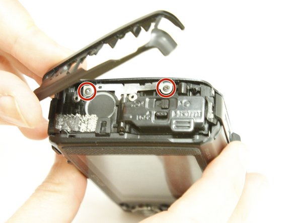

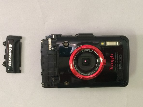

    • Locate the side of the camera with the connector cover.
    • Remove the 2 Phillips #00 4.6mm casing screws.
  2. Olympus Stylus Tough TG-2 iHS Display Replacement: crwdns2935265:02crwdnd2935265:01crwdnd2935265:02crwdne2935265:0 Olympus Stylus Tough TG-2 iHS Display Replacement: crwdns2935265:02crwdnd2935265:02crwdnd2935265:02crwdne2935265:0
    • Open the connector cover by sliding the tab labeled lock to revile orange.
    • Slide the connector cover lock to revile orange and the door will spring open.
    • Remove the single internal Phillips #00 3.77mm screw.
  3. Olympus Stylus Tough TG-2 iHS Display Replacement: crwdns2935265:03crwdnd2935265:01crwdnd2935265:03crwdne2935265:0 Olympus Stylus Tough TG-2 iHS Display Replacement: crwdns2935265:03crwdnd2935265:02crwdnd2935265:03crwdne2935265:0 Olympus Stylus Tough TG-2 iHS Display Replacement: crwdns2935265:03crwdnd2935265:03crwdnd2935265:03crwdne2935265:0

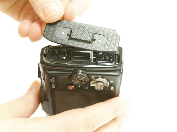

    • Close the door to gain access to the casing.
    • Use your fingers to remove the black plastic casing that surrounds the connector door.
    • Use your fingers to remove the next black plastic piece .
    • Remove the two screws revealed

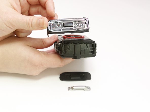

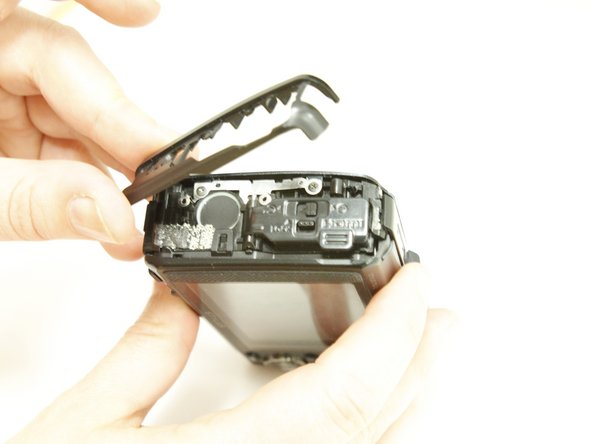

  4. Olympus Stylus Tough TG-2 iHS Display Replacement, Strap Eyelet Casing: crwdns2935265:04crwdnd2935265:01crwdnd2935265:03crwdne2935265:0 Olympus Stylus Tough TG-2 iHS Display Replacement, Strap Eyelet Casing: crwdns2935265:04crwdnd2935265:02crwdnd2935265:03crwdne2935265:0 Olympus Stylus Tough TG-2 iHS Display Replacement, Strap Eyelet Casing: crwdns2935265:04crwdnd2935265:03crwdnd2935265:03crwdne2935265:0
    • Locate the strap eyelet side of the camera and remove the 2 Phillips #00 5.3mm screws in the handle.
    • Using your fingers, take off the handle, the black casing underneath, and gently wiggle out the shiny black casing below that.

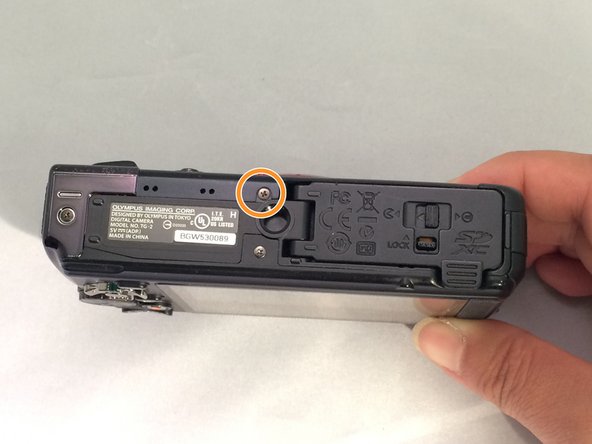

  5. Olympus Stylus Tough TG-2 iHS Display Replacement: crwdns2935265:05crwdnd2935265:01crwdnd2935265:03crwdne2935265:0 Olympus Stylus Tough TG-2 iHS Display Replacement: crwdns2935265:05crwdnd2935265:02crwdnd2935265:03crwdne2935265:0 Olympus Stylus Tough TG-2 iHS Display Replacement: crwdns2935265:05crwdnd2935265:03crwdnd2935265:03crwdne2935265:0
    • On the bottom of the camera, remove the single Phillips #00 3.5mm screw from the casing below the grip.
    • Using a plastic opening tool, gently pry the Olympus grip up and remove it.

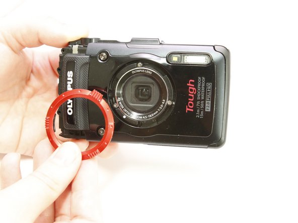

    • Remove the red ring surrounding the lens by twisting it counter-clockwise

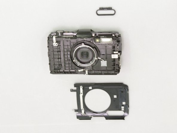

    • Remove the 2 Phillips #00 3.4mm screws that secure the faceplate just reveled by the grip.
    • On the bottom of the camera, remove the single Phillips #00 3.4mm screw by the tripod socket securing the face plate.
  8. Olympus Stylus Tough TG-2 iHS Display Replacement: crwdns2935265:08crwdnd2935265:01crwdnd2935265:03crwdne2935265:0 Olympus Stylus Tough TG-2 iHS Display Replacement: crwdns2935265:08crwdnd2935265:02crwdnd2935265:03crwdne2935265:0 Olympus Stylus Tough TG-2 iHS Display Replacement: crwdns2935265:08crwdnd2935265:03crwdnd2935265:03crwdne2935265:0
    • Use a plastic prying tool to lift and remove the faceplate .
    • There will be some resistance from a sticker just under the GPS logo.
    • The black plastic ring around the flash may fall as it is no longer secure.

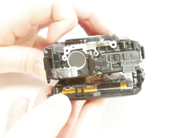

  11. Olympus Stylus Tough TG-2 iHS Display Replacement: crwdns2935265:011crwdnd2935265:01crwdnd2935265:02crwdne2935265:0 Olympus Stylus Tough TG-2 iHS Display Replacement: crwdns2935265:011crwdnd2935265:02crwdnd2935265:02crwdne2935265:0

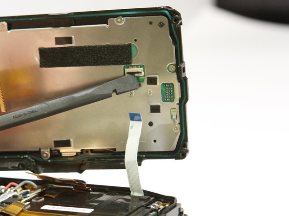

    • Locate the clasp for the white ribbon.
    • Use the spudger to lift the clasp releasing the ribbon
  12. Olympus Stylus Tough TG-2 iHS Display Replacement: crwdns2935265:012crwdnd2935265:01crwdnd2935265:02crwdne2935265:0 Olympus Stylus Tough TG-2 iHS Display Replacement: crwdns2935265:012crwdnd2935265:02crwdnd2935265:02crwdne2935265:0
    • Locate the clasp for the orange ribbon in between the motherboard and lens box.
    • Use the spudger to lift the clasp releasing the ribbon.
  13. Olympus Stylus Tough TG-2 iHS Display Replacement: crwdns2935265:013crwdnd2935265:01crwdnd2935265:02crwdne2935265:0 Olympus Stylus Tough TG-2 iHS Display Replacement: crwdns2935265:013crwdnd2935265:02crwdnd2935265:02crwdne2935265:0
    • Next pry up on the white connector using the spudger to free the screen from the device.
    • The housing and monitor will be separated.

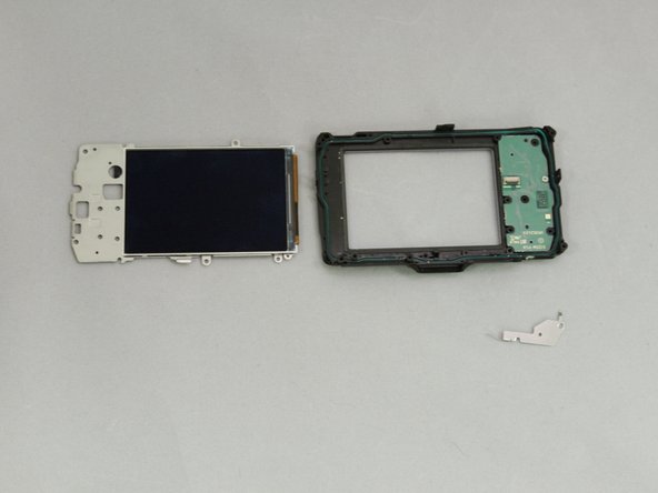

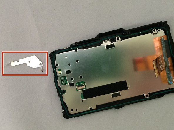

  14. Olympus Stylus Tough TG-2 iHS Display Replacement, Display: crwdns2935265:014crwdnd2935265:01crwdnd2935265:02crwdne2935265:0 Olympus Stylus Tough TG-2 iHS Display Replacement, Display: crwdns2935265:014crwdnd2935265:02crwdnd2935265:02crwdne2935265:0
    • On the back of the separated monitor, remove the 10 silver Phillips #00 4.4mm screws and the 1 black Phillips #00 3.26mm screw.
    • Use your fingers to remove the small corner metal triangle.
  15. Olympus Stylus Tough TG-2 iHS Display Replacement: crwdns2935265:015crwdnd2935265:01crwdnd2935265:02crwdne2935265:0 Olympus Stylus Tough TG-2 iHS Display Replacement: crwdns2935265:015crwdnd2935265:02crwdnd2935265:02crwdne2935265:0
    • Using the spudger on the edge of the screen to lift it and remove the metal backing attached to the screen.
