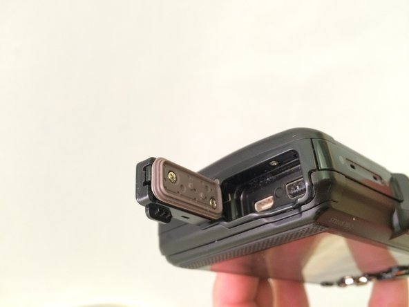

  3. Olympus Stylus Tough TG-2 iHS Battery and Connector Seals Replacement: crwdns2935265:03crwdnd2935265:01crwdnd2935265:02crwdne2935265:0 Olympus Stylus Tough TG-2 iHS Battery and Connector Seals Replacement: crwdns2935265:03crwdnd2935265:02crwdnd2935265:02crwdne2935265:0
    • Locate the connector cover on the side of the camera.
    • Slide the tab labeled lock to show orange.
    • Slide the connector cover lock to revile orange and the door will spring open.

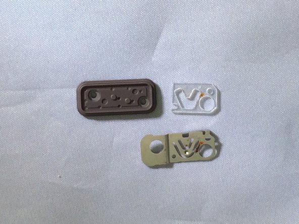

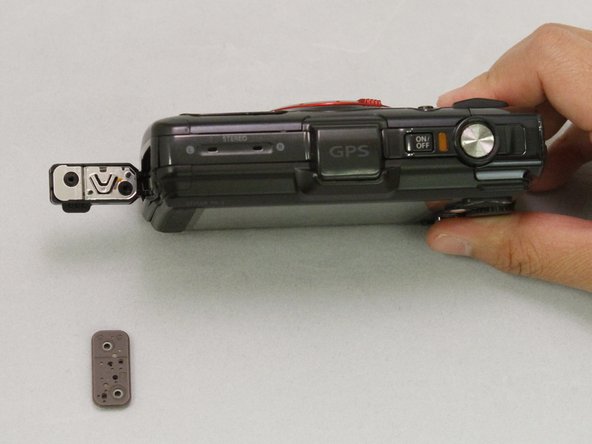

  4. Olympus Stylus Tough TG-2 iHS Battery and Connector Seals Replacement: crwdns2935265:04crwdnd2935265:01crwdnd2935265:03crwdne2935265:0 Olympus Stylus Tough TG-2 iHS Battery and Connector Seals Replacement: crwdns2935265:04crwdnd2935265:02crwdnd2935265:03crwdne2935265:0 Olympus Stylus Tough TG-2 iHS Battery and Connector Seals Replacement: crwdns2935265:04crwdnd2935265:03crwdnd2935265:03crwdne2935265:0
    • Remove the 2 Phillips #00 screws on the inner connector door.
    • Use a spudger to release the seal, the clear plastic piece, and the metal piece.
