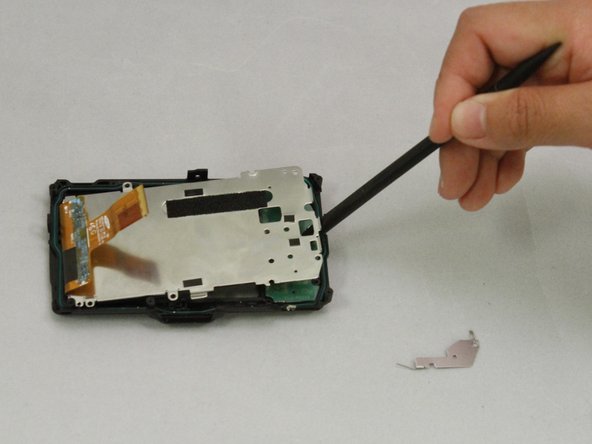

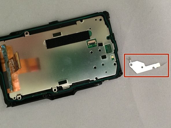

  14. Olympus Stylus Tough TG-2 iHS Back Panel & Buttons Replacement, Back Panel & Buttons: crwdns2935265:014crwdnd2935265:01crwdnd2935265:03crwdne2935265:0 Olympus Stylus Tough TG-2 iHS Back Panel & Buttons Replacement, Back Panel & Buttons: crwdns2935265:014crwdnd2935265:02crwdnd2935265:03crwdne2935265:0 Olympus Stylus Tough TG-2 iHS Back Panel & Buttons Replacement, Back Panel & Buttons: crwdns2935265:014crwdnd2935265:03crwdnd2935265:03crwdne2935265:0
    • On the back of the separated monitor, remove the 10 silver Phillips #00 4.4mm screws and the 1 black Phillips #00 3.26mm screw.
    • Use your fingers to remove the small corner metal triangle.
    • Using the spudger on the edge of the screen to lift it and remove the metal insert.

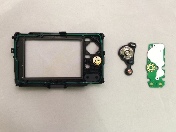

  15. Olympus Stylus Tough TG-2 iHS Back Panel & Buttons Replacement: crwdns2935265:015crwdnd2935265:01crwdnd2935265:02crwdne2935265:0 Olympus Stylus Tough TG-2 iHS Back Panel & Buttons Replacement: crwdns2935265:015crwdnd2935265:02crwdnd2935265:02crwdne2935265:0
    • Use your fingers to lift the green circuit board and buttons out of the case.
