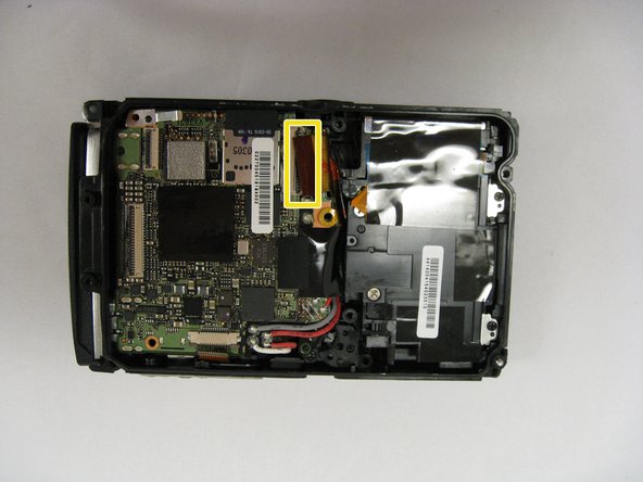

  10. Olympus Stylus Tough 6020 Motherboard Replacement, Ribbon Cables: crwdns2935265:010crwdnd2935265:01crwdnd2935265:01crwdne2935265:0
    • Using tweezers, disconnect the white ribbon cable from the motherboard.
    • Using tweezers, disconnect the brown ribbon cable from the motherboard.
  11. Olympus Stylus Tough 6020 Motherboard Replacement, Metal Panel: crwdns2935265:011crwdnd2935265:01crwdnd2935265:01crwdne2935265:0
    • Using a screwdriver, unscrew the four screws off of the center metal panel.
    • Using tweezers, disconnect the ribbon cable from the motherboard.
    • Using tweezers, remove the metal panel.

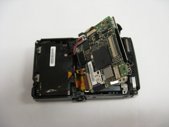

  12. Olympus Stylus Tough 6020 Motherboard Replacement, Motherboard: crwdns2935265:012crwdnd2935265:01crwdnd2935265:03crwdne2935265:0 Olympus Stylus Tough 6020 Motherboard Replacement, Motherboard: crwdns2935265:012crwdnd2935265:02crwdnd2935265:03crwdne2935265:0 Olympus Stylus Tough 6020 Motherboard Replacement, Motherboard: crwdns2935265:012crwdnd2935265:03crwdnd2935265:03crwdne2935265:0
    • Using a screwdriver, unscrew the black screw on the top left of the motherboard.
    • Using a screwdriver, unscrew the screw on the bottom left of the motherboard.
    • Using tweezers, disconnect the ribbon cable on the top right of the motherboard.
    • Using tweezers, disconnect the ribbon cable on the bottom right of the motherboard.
    • Using a spudger, pry the motherboard up.

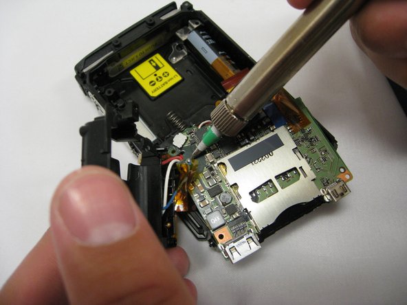

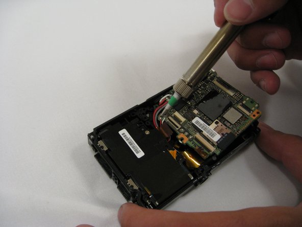

  13. Olympus Stylus Tough 6020 Motherboard Replacement: crwdns2935265:013crwdnd2935265:01crwdnd2935265:03crwdne2935265:0 Olympus Stylus Tough 6020 Motherboard Replacement: crwdns2935265:013crwdnd2935265:02crwdnd2935265:03crwdne2935265:0 Olympus Stylus Tough 6020 Motherboard Replacement: crwdns2935265:013crwdnd2935265:03crwdnd2935265:03crwdne2935265:0
    • Using a soldering iron, desolder the red and white cables that are connected to the motherboard.
    • Using a soldering iron, desolder the blue wire on the back of the motherboard.
