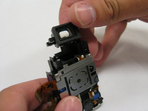

  10. Olympus Stylus Tough 6020 Lens Replacement, Lens: crwdns2935265:010crwdnd2935265:01crwdnd2935265:01crwdne2935265:0
    • Unscrew screws on place holder plates
  11. Olympus Stylus Tough 6020 Lens Replacement: crwdns2935265:011crwdnd2935265:01crwdnd2935265:01crwdne2935265:0
    • Gently lift Lens compartment out of device.
  12. Olympus Stylus Tough 6020 Lens Replacement: crwdns2935265:012crwdnd2935265:01crwdnd2935265:01crwdne2935265:0
    • From top view, unscrew 3 screws
    • Do not worry about the screw on top of the 2 screws.
  13. Olympus Stylus Tough 6020 Lens Replacement: crwdns2935265:013crwdnd2935265:01crwdnd2935265:02crwdne2935265:0 Olympus Stylus Tough 6020 Lens Replacement: crwdns2935265:013crwdnd2935265:02crwdnd2935265:02crwdne2935265:0
    • Lens comes off
