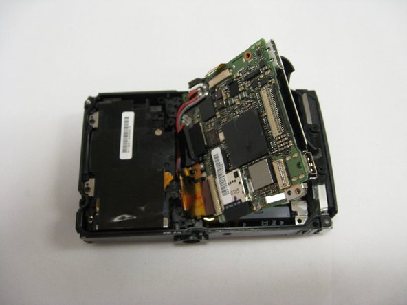

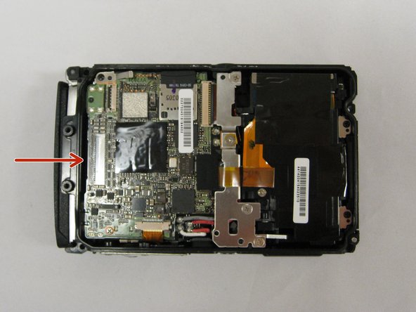

  11. Olympus Stylus Tough 6020 Flash Replacement, Motherboard: crwdns2935265:011crwdnd2935265:01crwdnd2935265:03crwdne2935265:0 Olympus Stylus Tough 6020 Flash Replacement, Motherboard: crwdns2935265:011crwdnd2935265:02crwdnd2935265:03crwdne2935265:0 Olympus Stylus Tough 6020 Flash Replacement, Motherboard: crwdns2935265:011crwdnd2935265:03crwdnd2935265:03crwdne2935265:0
    • Using the Phillips #00 Screwdriver, unscrew the four 3.9mm screws from the center metal panel.
    • Using the tweezers, pull the metal panel to remove it from the motherboard.
    • Using the tweezers, disconnect the ribbon cable from the motherboard.
    • Using the Phillips #00 Screwdriver, unscrew the two 3.9mm screws on the top left and bottom left of the motherboard.
    • Using the tweezers, disconnect the ribbon cable from the bottom left of the motherboard.
    • Using the spudger, gently pry the motherboard from the casing.

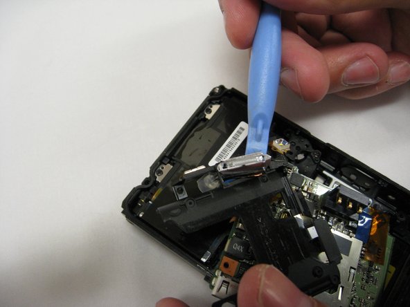

  12. Olympus Stylus Tough 6020 Flash Replacement, Capacitor Case: crwdns2935265:012crwdnd2935265:01crwdnd2935265:01crwdne2935265:0
    • Using your hands, separate the black frame from the motherboard.
    • Using your hands, separate the metal plate from between the flash casing and the motherboard.

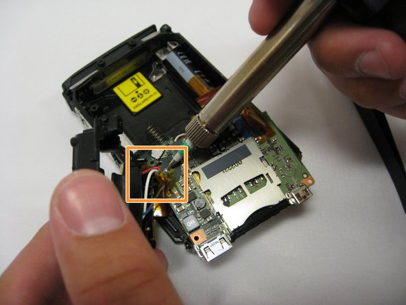

  13. Olympus Stylus Tough 6020 Flash Replacement, Capacitor: crwdns2935265:013crwdnd2935265:01crwdnd2935265:03crwdne2935265:0 Olympus Stylus Tough 6020 Flash Replacement, Capacitor: crwdns2935265:013crwdnd2935265:02crwdnd2935265:03crwdne2935265:0 Olympus Stylus Tough 6020 Flash Replacement, Capacitor: crwdns2935265:013crwdnd2935265:03crwdnd2935265:03crwdne2935265:0
    • Using the tweezers, grab and pull the yellow tape off the blue and white wires.
    • Using the soldering station, desolder the blue wire from the back of the motherboard.
    • Using the spudger, carefully pry the capacitor from the flash casing.
    • If the capacitor is touched, you could get shocked.
