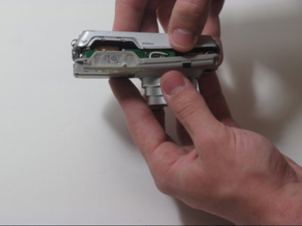

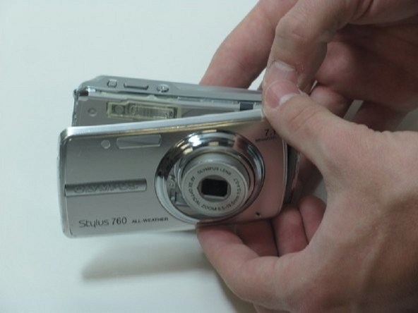

    4. Olympus Stylus 760 LCD Screen Replacement: crwdns2935265:07crwdnd2935265:01crwdnd2935265:03crwdne2935265:0 Olympus Stylus 760 LCD Screen Replacement: crwdns2935265:07crwdnd2935265:02crwdnd2935265:03crwdne2935265:0 Olympus Stylus 760 LCD Screen Replacement: crwdns2935265:07crwdnd2935265:03crwdnd2935265:03crwdne2935265:0
      • Separate the front casing from the back using a plastic opening tool, gently.
      • Silver band and buttons will become loose when you remove the two pieces.

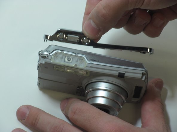

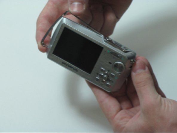

    5. Olympus Stylus 760 LCD Screen Replacement: crwdns2935265:08crwdnd2935265:01crwdnd2935265:02crwdne2935265:0 Olympus Stylus 760 LCD Screen Replacement: crwdns2935265:08crwdnd2935265:02crwdnd2935265:02crwdne2935265:0
      • Pull the silver bracket off of the camera

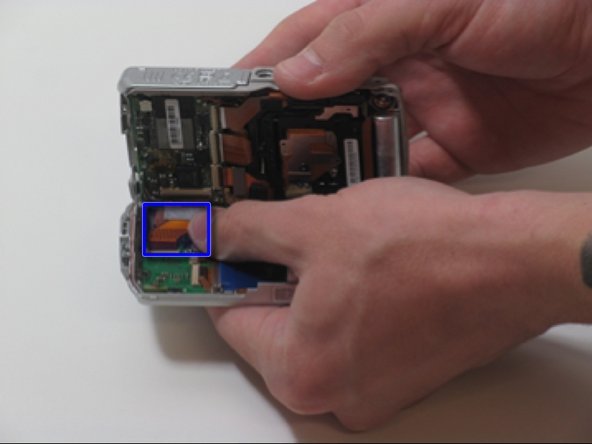

    6. Olympus Stylus 760 LCD Screen Replacement: crwdns2935265:09crwdnd2935265:01crwdnd2935265:03crwdne2935265:0 Olympus Stylus 760 LCD Screen Replacement: crwdns2935265:09crwdnd2935265:02crwdnd2935265:03crwdne2935265:0 Olympus Stylus 760 LCD Screen Replacement: crwdns2935265:09crwdnd2935265:03crwdnd2935265:03crwdne2935265:0
      • Remove the 4 screws on the inner face of the camera.
      • Circuit ribbon is attached at the top left of the camera. Be careful when separating the front and back of the camera.
      • Pull the camera apart into 2 separate pieces.

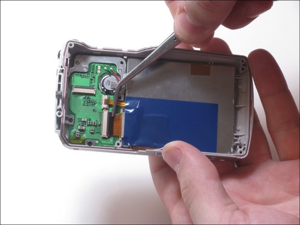

    8. Olympus Stylus 760 LCD Screen Replacement: crwdns2935265:011crwdnd2935265:01crwdnd2935265:02crwdne2935265:0 Olympus Stylus 760 LCD Screen Replacement: crwdns2935265:011crwdnd2935265:02crwdnd2935265:02crwdne2935265:0
      • Remove 4 screws holding the LCD screen in place.
      • Be cautious of the brackets that come loose when you remove the 3 screws on the right side of the camera
      • LCD Screen is attached to 2 ribbon wires

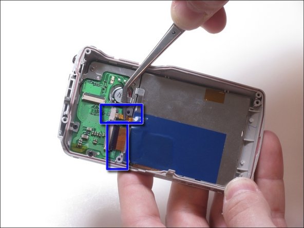

    9. Olympus Stylus 760 LCD Screen Replacement: crwdns2935265:012crwdnd2935265:01crwdnd2935265:02crwdne2935265:0 Olympus Stylus 760 LCD Screen Replacement: crwdns2935265:012crwdnd2935265:02crwdnd2935265:02crwdne2935265:0
      • Pull up on the small ribbon wire to disconnect it from the circuit board
      • Flip the little black clip up to remove the larger ribbon wire from the circuit board.
