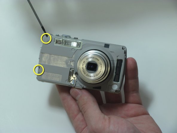

    • Remove the 2 screws from the bottom of the camera
  2. Olympus Stylus 760 Case Replacement: crwdns2935265:02crwdnd2935265:01crwdnd2935265:01crwdne2935265:0
    • Remove the screw from the right side of the camera.
  3. Olympus Stylus 760 Case Replacement: crwdns2935265:03crwdnd2935265:01crwdnd2935265:01crwdne2935265:0
    • Remove the two screws from the left side of the camera

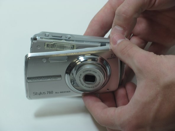

  4. Olympus Stylus 760 Case Replacement: crwdns2935265:04crwdnd2935265:01crwdnd2935265:03crwdne2935265:0 Olympus Stylus 760 Case Replacement: crwdns2935265:04crwdnd2935265:02crwdnd2935265:03crwdne2935265:0 Olympus Stylus 760 Case Replacement: crwdns2935265:04crwdnd2935265:03crwdnd2935265:03crwdne2935265:0
    • Separate the front casing from the back using a plastic opening tool, gently.
    • Silver band and buttons will become loose when you remove the two pieces.

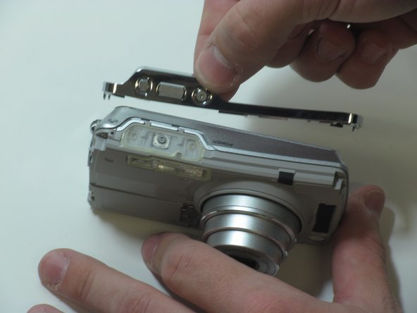

  5. Olympus Stylus 760 Case Replacement: crwdns2935265:05crwdnd2935265:01crwdnd2935265:02crwdne2935265:0 Olympus Stylus 760 Case Replacement: crwdns2935265:05crwdnd2935265:02crwdnd2935265:02crwdne2935265:0
    • Pull the silver bracket and buttons off of the camera

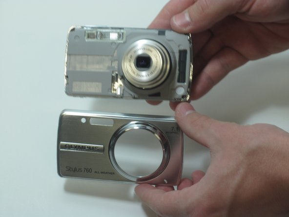

  6. Olympus Stylus 760 Case Replacement: crwdns2935265:06crwdnd2935265:01crwdnd2935265:03crwdne2935265:0 Olympus Stylus 760 Case Replacement: crwdns2935265:06crwdnd2935265:02crwdnd2935265:03crwdne2935265:0 Olympus Stylus 760 Case Replacement: crwdns2935265:06crwdnd2935265:03crwdnd2935265:03crwdne2935265:0
    • Remove the 2 screws on the right side of the camera.
    • Remove the 2 screws on the left side of the camera.
    • Circuit ribbon is attached at the top-left of the camera. Be careful when separating the front and back of the camera.
    • Pull the camera apart into 2 separate pieces.

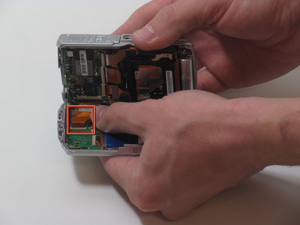

  7. Olympus Stylus 760 Case Replacement: crwdns2935265:07crwdnd2935265:01crwdnd2935265:01crwdne2935265:0
    • Flip up clip on circuit ribbon, carefully
    • Detach the ribbon from the rear to the front and pull it out, gently.
