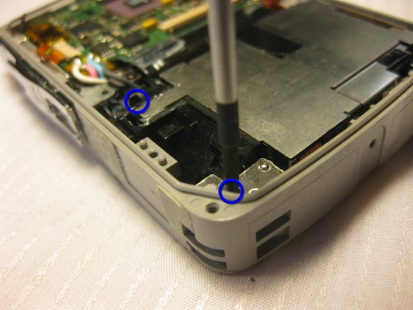

      • Remove the four 3 mm long cover screws at the corners of the camera using a Phillips #00 screwdriver.
      • Remove the 2 mm long screws securing the sides of the camera which holds the back panel using a Phillips #00 screwdriver.

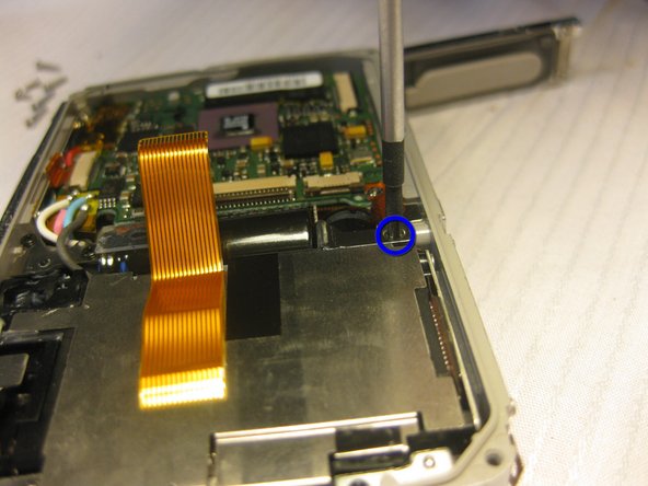

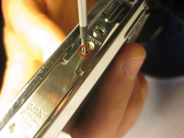

    1. Olympus Stylus 725 SW Lens Replacement, Front Panel: crwdns2935265:03crwdnd2935265:01crwdnd2935265:03crwdne2935265:0 Olympus Stylus 725 SW Lens Replacement, Front Panel: crwdns2935265:03crwdnd2935265:02crwdnd2935265:03crwdne2935265:0 Olympus Stylus 725 SW Lens Replacement, Front Panel: crwdns2935265:03crwdnd2935265:03crwdnd2935265:03crwdne2935265:0

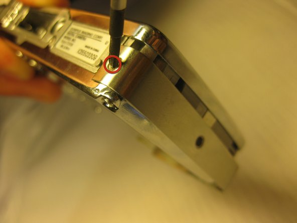

      • Remove the top screws using a 1.5 mm screwdriver.
      • Remove the single side screw located on the side of the camera where the tab is, using a #00 screwdriver.

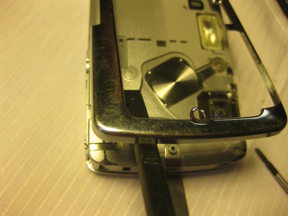

      • Using a #00 Philips Head Screwdriver, remove the screws located on all four sides of the camera.
    2. Olympus Stylus 725 SW Lens Replacement: crwdns2935265:05crwdnd2935265:01crwdnd2935265:03crwdne2935265:0 Olympus Stylus 725 SW Lens Replacement: crwdns2935265:05crwdnd2935265:02crwdnd2935265:03crwdne2935265:0 Olympus Stylus 725 SW Lens Replacement: crwdns2935265:05crwdnd2935265:03crwdnd2935265:03crwdne2935265:0
      • After removing all four of the screws, pry the side covers off of the camera.

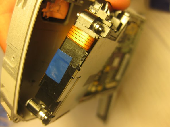

    1. Olympus Stylus 725 SW Lens Replacement, Lens: crwdns2935265:06crwdnd2935265:01crwdnd2935265:03crwdne2935265:0 Olympus Stylus 725 SW Lens Replacement, Lens: crwdns2935265:06crwdnd2935265:02crwdnd2935265:03crwdne2935265:0 Olympus Stylus 725 SW Lens Replacement, Lens: crwdns2935265:06crwdnd2935265:03crwdnd2935265:03crwdne2935265:0

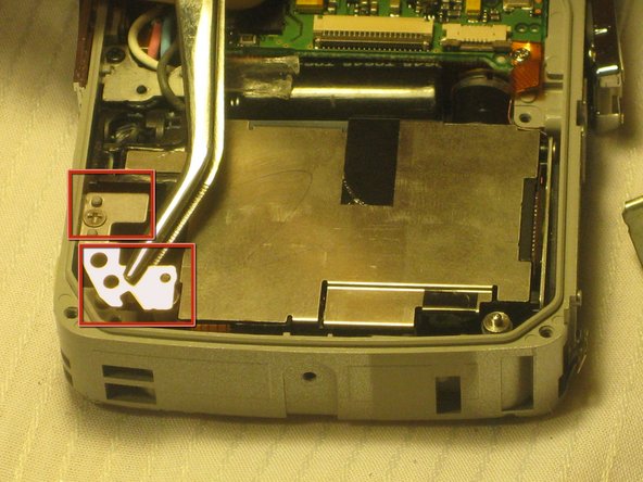

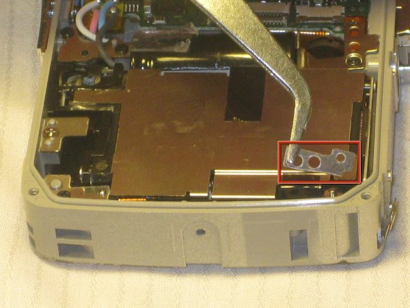

      • Unscrew four 2mm long screws using the #00 Phillips screwdriver.
    2. Olympus Stylus 725 SW Lens Replacement: crwdns2935265:07crwdnd2935265:01crwdnd2935265:03crwdne2935265:0 Olympus Stylus 725 SW Lens Replacement: crwdns2935265:07crwdnd2935265:02crwdnd2935265:03crwdne2935265:0 Olympus Stylus 725 SW Lens Replacement: crwdns2935265:07crwdnd2935265:03crwdnd2935265:03crwdne2935265:0
      • Remove four metal tabs from corners where the 2mm long screws were attached using tweezers.

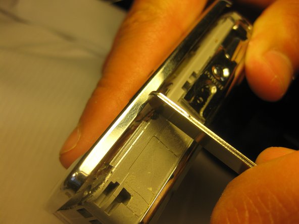

    3. Olympus Stylus 725 SW Lens Replacement: crwdns2935265:08crwdnd2935265:01crwdnd2935265:02crwdne2935265:0 Olympus Stylus 725 SW Lens Replacement: crwdns2935265:08crwdnd2935265:02crwdnd2935265:02crwdne2935265:0
      • Remove the viewfinder lens using a prying device.
      • There will be two ribbons attached to the viewfinder. Remove the ribbons by sliding them off the viewfinder with your thumb.
