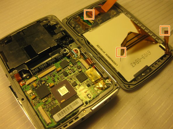

    1. Olympus Stylus 725 SW LCD Screen Replacement, Disassembling Olympus Stylus 725 SW Back Panel: crwdns2935265:02crwdnd2935265:01crwdnd2935265:03crwdne2935265:0 Olympus Stylus 725 SW LCD Screen Replacement, Disassembling Olympus Stylus 725 SW Back Panel: crwdns2935265:02crwdnd2935265:02crwdnd2935265:03crwdne2935265:0 Olympus Stylus 725 SW LCD Screen Replacement, Disassembling Olympus Stylus 725 SW Back Panel: crwdns2935265:02crwdnd2935265:03crwdnd2935265:03crwdne2935265:0
      • Remove the four 3 mm long cover screws at the corners of the camera using a Phillips #00 screwdriver.
      • Remove the 2 mm long screws securing the sides of the camera which holds the back panel using a Phillips #00 screwdriver.
    2. Olympus Stylus 725 SW LCD Screen Replacement: crwdns2935265:03crwdnd2935265:01crwdnd2935265:02crwdne2935265:0 Olympus Stylus 725 SW LCD Screen Replacement: crwdns2935265:03crwdnd2935265:02crwdnd2935265:02crwdne2935265:0
      • Be careful when removing the back cover; you will need to detach the connecting ribbons. Use tweezers if necessary.
      • Detach the ribbons using your thumb, sliding them out of their slots.
      • Set the back panel face up to keep the ribbons from touching anything.

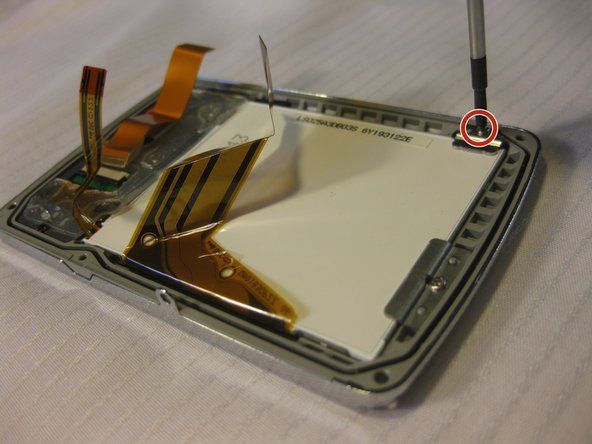

    1. Olympus Stylus 725 SW LCD Screen Replacement, LCD Screen: crwdns2935265:04crwdnd2935265:01crwdnd2935265:03crwdne2935265:0 Olympus Stylus 725 SW LCD Screen Replacement, LCD Screen: crwdns2935265:04crwdnd2935265:02crwdnd2935265:03crwdne2935265:0 Olympus Stylus 725 SW LCD Screen Replacement, LCD Screen: crwdns2935265:04crwdnd2935265:03crwdnd2935265:03crwdne2935265:0
      • Remove the screws in the back panel using a Phillips #00 screwdriver.
      • Detach the ribbon cables that connect the LCD to the back panel of the camera.

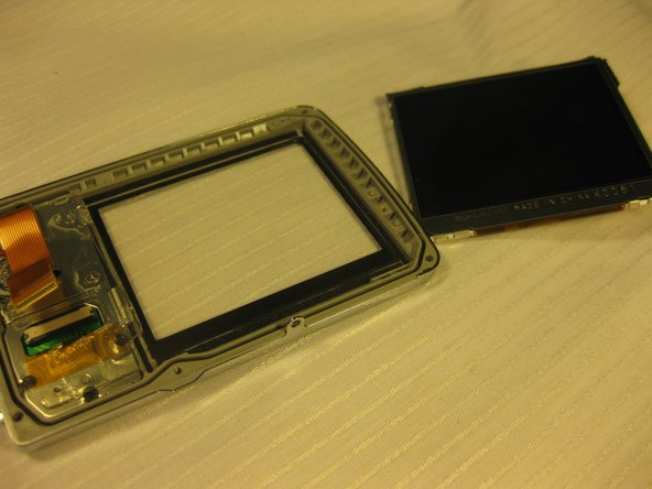

    2. Olympus Stylus 725 SW LCD Screen Replacement: crwdns2935265:05crwdnd2935265:01crwdnd2935265:02crwdne2935265:0 Olympus Stylus 725 SW LCD Screen Replacement: crwdns2935265:05crwdnd2935265:02crwdnd2935265:02crwdne2935265:0
      • Use tweezers to remove the loosened LCD screen.
      • Be careful to not scratch the new LCD screen when replacing it.
      • Carefully place the new screen in place of the old, making sure the label faces up.
