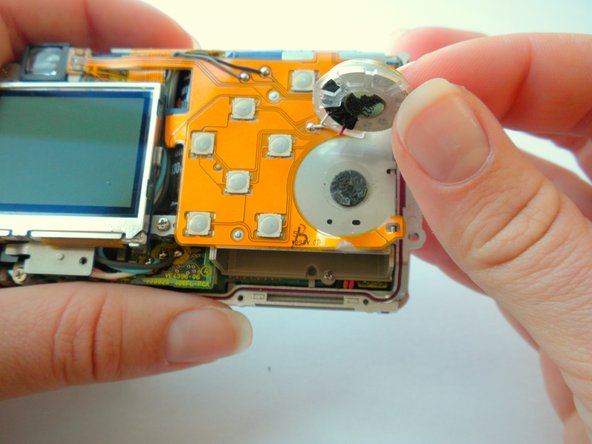

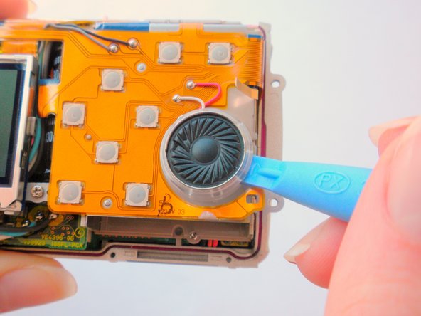

  8. Olympus Stylus 410 Speaker Replacement, Speaker: crwdns2935265:08crwdnd2935265:01crwdnd2935265:03crwdne2935265:0 Olympus Stylus 410 Speaker Replacement, Speaker: crwdns2935265:08crwdnd2935265:02crwdnd2935265:03crwdne2935265:0 Olympus Stylus 410 Speaker Replacement, Speaker: crwdns2935265:08crwdnd2935265:03crwdnd2935265:03crwdne2935265:0
    • Use a spudger to remove the speaker. It is attached by a double sided adhesive so it should just peel off.
  9. Olympus Stylus 410 Speaker Replacement: crwdns2935265:09crwdnd2935265:01crwdnd2935265:01crwdne2935265:0
    • Un-solder the wires to remove the speaker.
