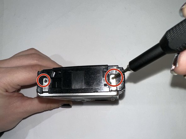

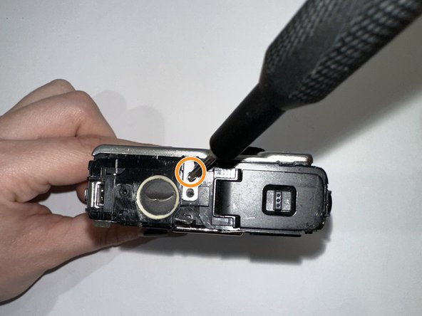

    • Use a Phillips #00 screwdriver to remove the screws from the side panel.
    • Use a Phillips #00 screwdriver to remove both of the screws from the battery door.

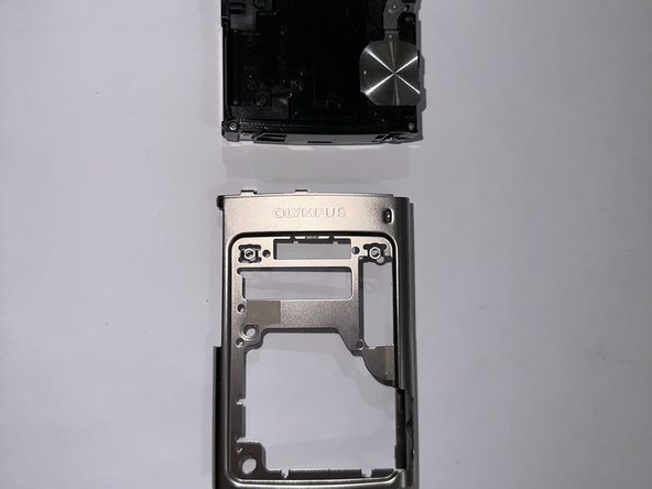

    • Flip the Olympus Stylus 1030 SW camera upside down, the rear side facing away from you.
    • Use a Phillips #00 screwdriver to remove both screws.

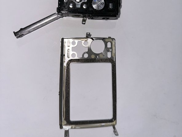

    • Now flip your camera with the rear side facing away from you. Remove both Phillips #00 screws.
    • You should now be able to remove the front case.

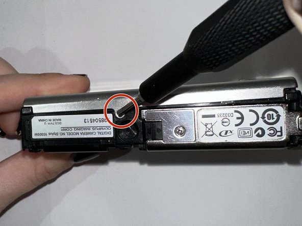

    • To remove the rear case of the camera, start with the rear end facing away from you.
    • Remove the two Phillips #00 screws.
    • Then flip the camera to the front facing you.
    • Remove the single Phillips #0 screw.

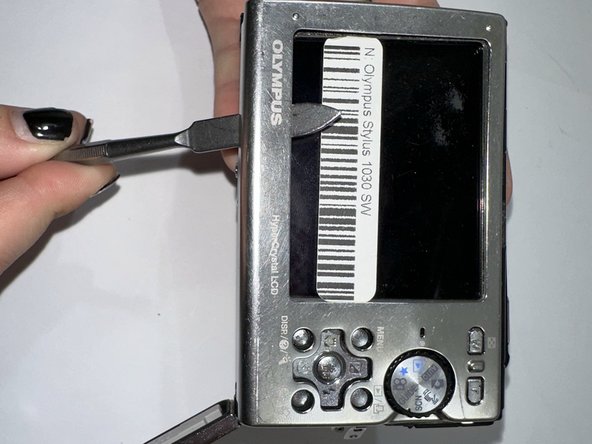

    • Now place your camera right side up with the front facing you.
    • Open the battery door and locate the screw placed in the middle.
    • Remove the Phillips #00 screw.
    • You now take your spatula to separate the rear case from the camera.
