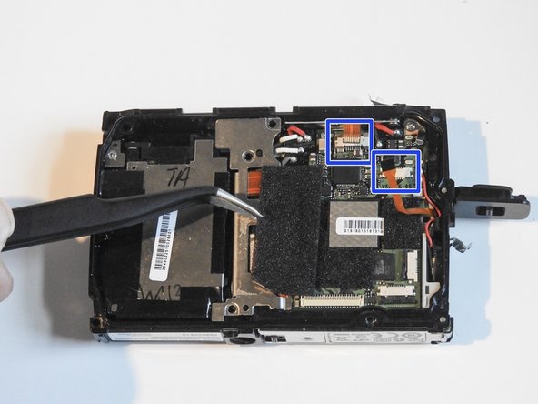

  11. Olympus Stylus 1030 SW Motherboard Replacement: crwdns2935265:011crwdnd2935265:01crwdnd2935265:03crwdne2935265:0 Olympus Stylus 1030 SW Motherboard Replacement: crwdns2935265:011crwdnd2935265:02crwdnd2935265:03crwdne2935265:0 Olympus Stylus 1030 SW Motherboard Replacement: crwdns2935265:011crwdnd2935265:03crwdnd2935265:03crwdne2935265:0
    • Using the spudger and tweezers if needed, remove the ribbons from the computer chips.

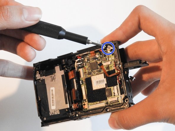

  12. Olympus Stylus 1030 SW Motherboard Replacement, Motherboard: crwdns2935265:012crwdnd2935265:01crwdnd2935265:03crwdne2935265:0 Olympus Stylus 1030 SW Motherboard Replacement, Motherboard: crwdns2935265:012crwdnd2935265:02crwdnd2935265:03crwdne2935265:0 Olympus Stylus 1030 SW Motherboard Replacement, Motherboard: crwdns2935265:012crwdnd2935265:03crwdnd2935265:03crwdne2935265:0
    • Remove the 1.0 cm and the 0.8 mm screws.
    • Peel off tape and remove ribbons.
    • Remove black plastic cover and unscrew the 1.1 cm screw.

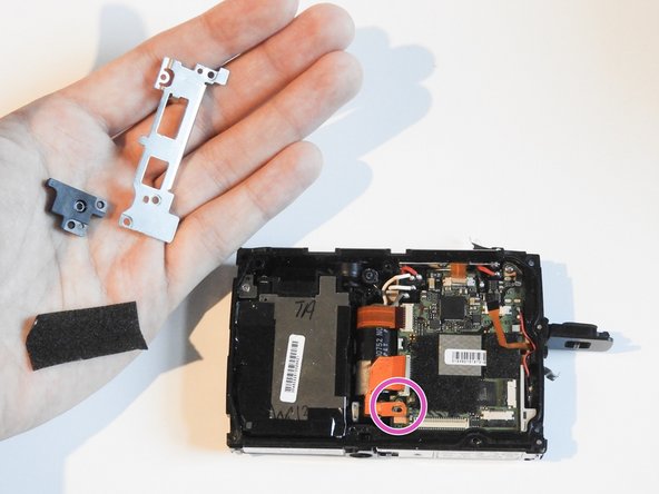

  13. Olympus Stylus 1030 SW Motherboard Replacement: crwdns2935265:013crwdnd2935265:01crwdnd2935265:02crwdne2935265:0 Olympus Stylus 1030 SW Motherboard Replacement: crwdns2935265:013crwdnd2935265:02crwdnd2935265:02crwdne2935265:0
    • Release ribbons carefully using either tweezers or a spudger.
    • Remove the 1.1 cm screw.

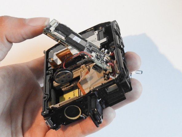

  14. Olympus Stylus 1030 SW Motherboard Replacement: crwdns2935265:014crwdnd2935265:01crwdnd2935265:03crwdne2935265:0 Olympus Stylus 1030 SW Motherboard Replacement: crwdns2935265:014crwdnd2935265:02crwdnd2935265:03crwdne2935265:0 Olympus Stylus 1030 SW Motherboard Replacement: crwdns2935265:014crwdnd2935265:03crwdnd2935265:03crwdne2935265:0
    • Push A/V port away from you carefully using a spudger.
    • Slowly take out the motherboard and the speaker microphone.
    • Collect the metal washer plate from the top right corner of the motherboard (now loose).

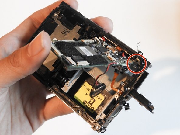

  15. Olympus Stylus 1030 SW Motherboard Replacement: crwdns2935265:015crwdnd2935265:01crwdnd2935265:02crwdne2935265:0 Olympus Stylus 1030 SW Motherboard Replacement: crwdns2935265:015crwdnd2935265:02crwdnd2935265:02crwdne2935265:0
    • With a spudger or finger, slowly take out the battery hinged to the motherboard.
    • Be careful not to disconnect the wires by pulling it too hard.
    • Take out motherboard.

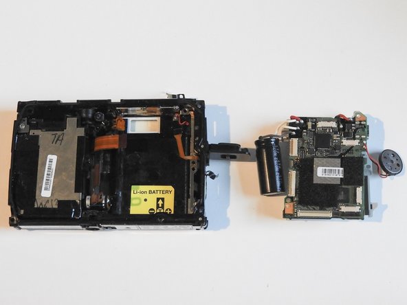

what is the voltage, and capacitance of the main flash capacitor? diameter and length? I want to replace mine as my 'flash charging' symbol constantly flashes and flash does not fire.
thanks for the writeup! I have more confidence in repairing my 10+ year old camera
Kevin Kay - crwdns2934203:0crwdne2934203:0
the cap is 330uF and 90V
dimensions:
11.94mm diameter
25.65mm length
