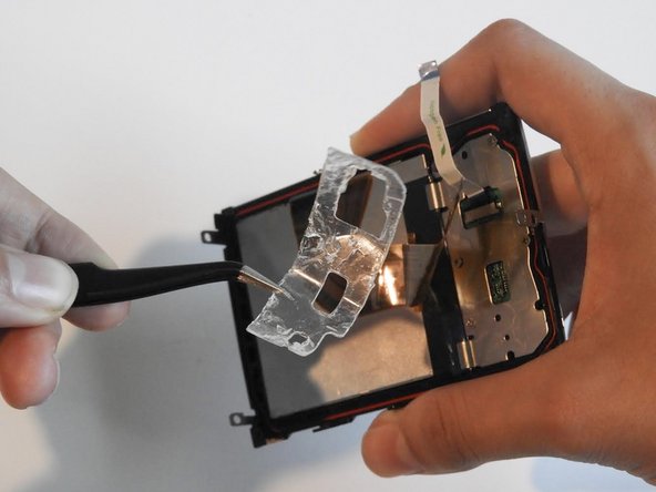

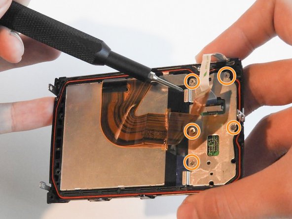

  12. Olympus Stylus 1030 SW LCD and Button Replacement, LCD and Buttons: crwdns2935265:012crwdnd2935265:01crwdnd2935265:03crwdne2935265:0 Olympus Stylus 1030 SW LCD and Button Replacement, LCD and Buttons: crwdns2935265:012crwdnd2935265:02crwdnd2935265:03crwdne2935265:0 Olympus Stylus 1030 SW LCD and Button Replacement, LCD and Buttons: crwdns2935265:012crwdnd2935265:03crwdnd2935265:03crwdne2935265:0
    • Unscrew the two screws found on the left side of the screen using the PH#00 head.
    • Peel off the gel tape using tweezers.
    • Unscrew the five 0.6 mm screws using the Phillips #00 screwdriver.

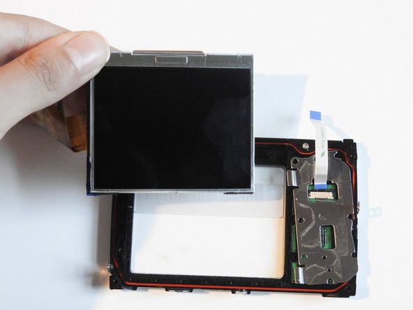

  13. Olympus Stylus 1030 SW LCD and Button Replacement: crwdns2935265:013crwdnd2935265:01crwdnd2935265:02crwdne2935265:0 Olympus Stylus 1030 SW LCD and Button Replacement: crwdns2935265:013crwdnd2935265:02crwdnd2935265:02crwdne2935265:0
    • Use the spudger to carefully pry off the LCD screen.

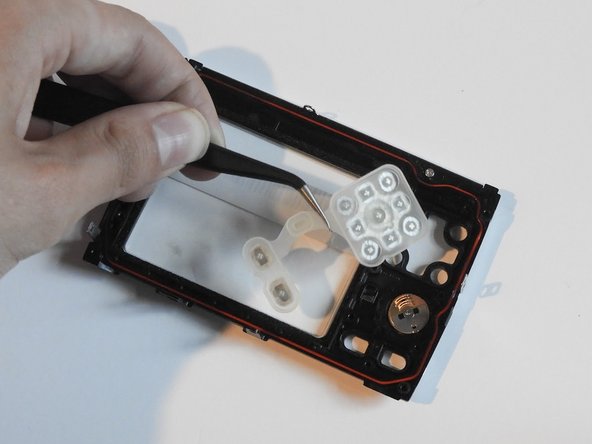

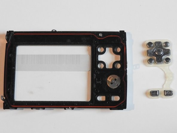

  14. Olympus Stylus 1030 SW LCD and Button Replacement: crwdns2935265:014crwdnd2935265:01crwdnd2935265:03crwdne2935265:0 Olympus Stylus 1030 SW LCD and Button Replacement: crwdns2935265:014crwdnd2935265:02crwdnd2935265:03crwdne2935265:0 Olympus Stylus 1030 SW LCD and Button Replacement: crwdns2935265:014crwdnd2935265:03crwdnd2935265:03crwdne2935265:0
    • Use the tweezers to take out the rubber button holder and its buttons.
