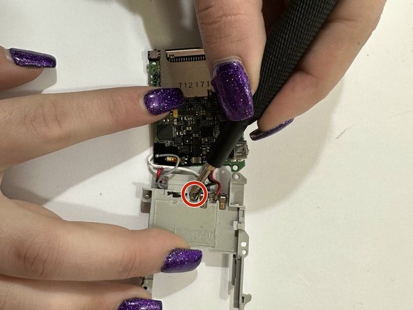

  14. Olympus Stylus 1030 SW Flash Assembly Replacement: crwdns2935265:014crwdnd2935265:01crwdnd2935265:02crwdne2935265:0 Olympus Stylus 1030 SW Flash Assembly Replacement: crwdns2935265:014crwdnd2935265:02crwdnd2935265:02crwdne2935265:0
    • Use your Phillips #00 screwdriver to remove the two screws holding the wires to the flash assembly.
  15. Olympus Stylus 1030 SW Flash Assembly Replacement: crwdns2935265:015crwdnd2935265:01crwdnd2935265:02crwdne2935265:0 Olympus Stylus 1030 SW Flash Assembly Replacement: crwdns2935265:015crwdnd2935265:02crwdnd2935265:02crwdne2935265:0
    • Use your tweezers to gently remove the last wires connected to the flash assembly.
