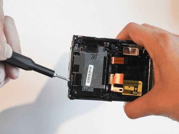

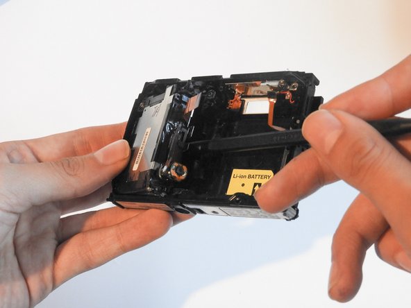

    1. Olympus Stylus 1030 SW Camera Lens Replacement, Camera Lens: crwdns2935265:012crwdnd2935265:01crwdnd2935265:03crwdne2935265:0 Olympus Stylus 1030 SW Camera Lens Replacement, Camera Lens: crwdns2935265:012crwdnd2935265:02crwdnd2935265:03crwdne2935265:0 Olympus Stylus 1030 SW Camera Lens Replacement, Camera Lens: crwdns2935265:012crwdnd2935265:03crwdnd2935265:03crwdne2935265:0
      • Peel off the black tape using tweezers.
      • Unscrew the 1.0 cm screw.
      • Use the spudger to carefully take out the lens compartment.

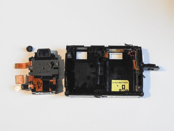

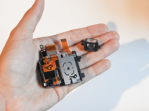

    2. Olympus Stylus 1030 SW Camera Lens Replacement: crwdns2935265:013crwdnd2935265:01crwdnd2935265:02crwdne2935265:0 Olympus Stylus 1030 SW Camera Lens Replacement: crwdns2935265:013crwdnd2935265:02crwdnd2935265:02crwdne2935265:0
      • Carefully take out the lens and the black plastic pieces along with it.

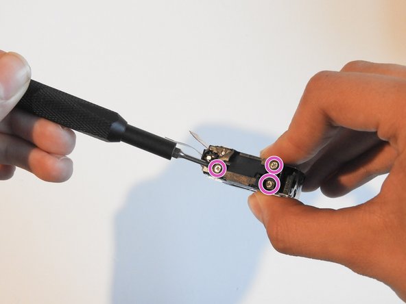

    3. Olympus Stylus 1030 SW Camera Lens Replacement: crwdns2935265:014crwdnd2935265:01crwdnd2935265:03crwdne2935265:0 Olympus Stylus 1030 SW Camera Lens Replacement: crwdns2935265:014crwdnd2935265:02crwdnd2935265:03crwdne2935265:0 Olympus Stylus 1030 SW Camera Lens Replacement: crwdns2935265:014crwdnd2935265:03crwdnd2935265:03crwdne2935265:0
      • Unscrew the three screws found on top of the mirror lens.
      • The mirror lens can now be removed.
