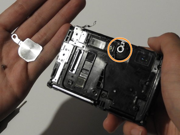

    2. Olympus Stylus 1030 SW Camera Disassembly: crwdns2935265:02crwdnd2935265:01crwdnd2935265:03crwdne2935265:0 Olympus Stylus 1030 SW Camera Disassembly: crwdns2935265:02crwdnd2935265:02crwdnd2935265:03crwdne2935265:0 Olympus Stylus 1030 SW Camera Disassembly: crwdns2935265:02crwdnd2935265:03crwdnd2935265:03crwdne2935265:0
      • Using the Phillips #00 screwdriver, unscrew the three screws.
      • Carefully swivel the metal cover out towards you.
      • Using tweezers, remove the metal washer.

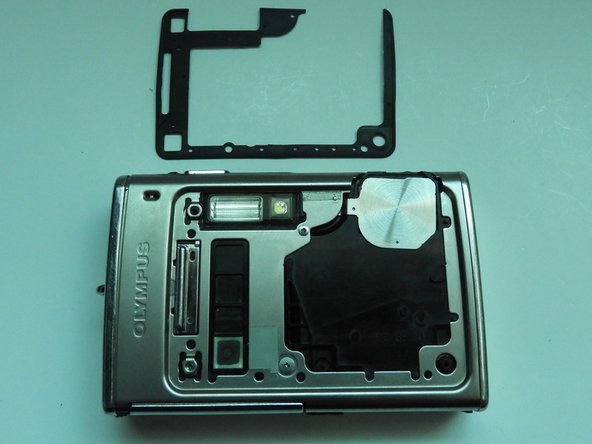

    3. Olympus Stylus 1030 SW Camera Disassembly: crwdns2935265:03crwdnd2935265:01crwdnd2935265:02crwdne2935265:0 Olympus Stylus 1030 SW Camera Disassembly: crwdns2935265:03crwdnd2935265:02crwdnd2935265:02crwdne2935265:0
      • Using the tweezers, slowly peel off the plate.

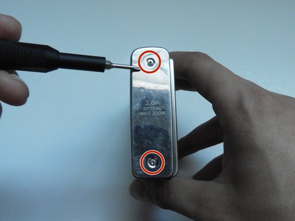

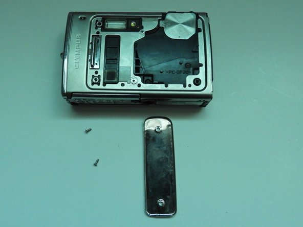

      • Using the Phillips #00 screwdriver, unscrew the two screws on the side of the camera.

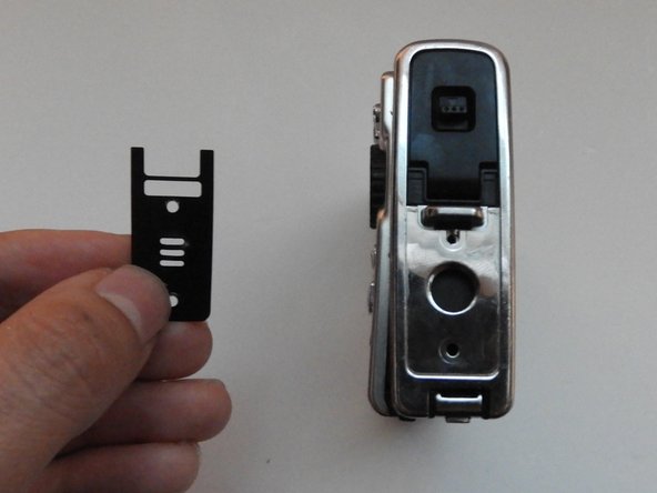

    5. Olympus Stylus 1030 SW Camera Disassembly: crwdns2935265:05crwdnd2935265:01crwdnd2935265:03crwdne2935265:0 Olympus Stylus 1030 SW Camera Disassembly: crwdns2935265:05crwdnd2935265:02crwdnd2935265:03crwdne2935265:0 Olympus Stylus 1030 SW Camera Disassembly: crwdns2935265:05crwdnd2935265:03crwdnd2935265:03crwdne2935265:0

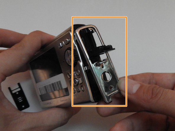

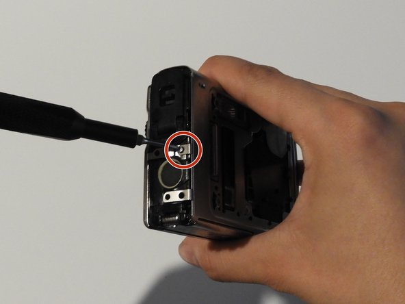

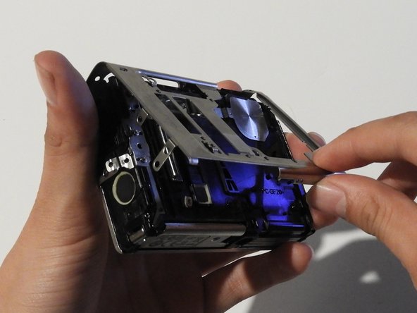

      • On the opposite side, use the Phillips #00 screwdriver to unscrew both screws.
      • Take out the speaker plate.
      • Open the multi-connector cover and slide off the side panel.

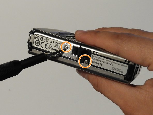

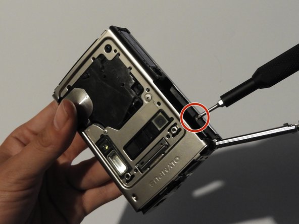

      • Using the Phillips #00 screwdriver, unscrew the screw above the speaker.
      • On the bottom side of the camera, unscrew the two screws.

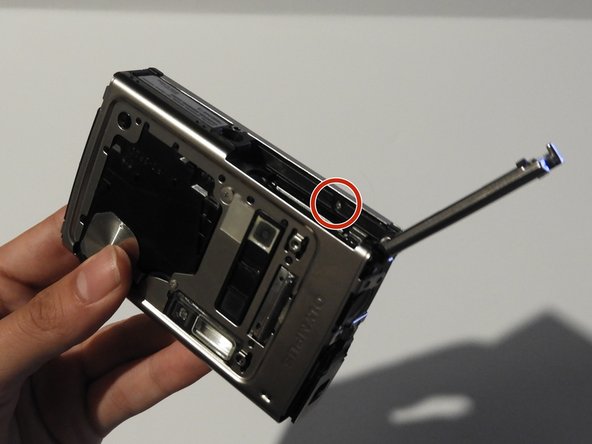

      • On the front of the camera, unscrew the two screws shown.

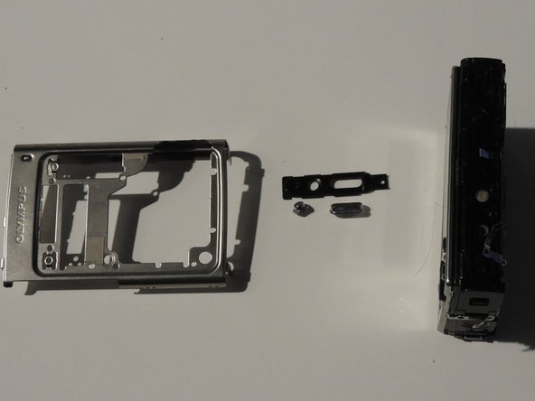

      • Gently pull on the side until the camera is separated from the back panel.
      • Remove the shutter and power button.

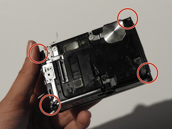

    9. Olympus Stylus 1030 SW Camera Disassembly: crwdns2935265:09crwdnd2935265:01crwdnd2935265:03crwdne2935265:0 Olympus Stylus 1030 SW Camera Disassembly: crwdns2935265:09crwdnd2935265:02crwdnd2935265:03crwdne2935265:0 Olympus Stylus 1030 SW Camera Disassembly: crwdns2935265:09crwdnd2935265:03crwdnd2935265:03crwdne2935265:0
      • Use the Phillips #00 screwdriver to unscrew the four screws on the front of the camera.
      • Unscrew the shutter using the Phillips #00 screwdriver.

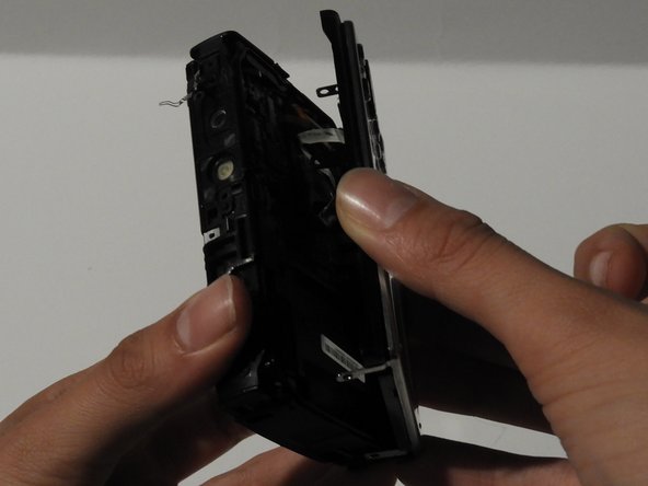

    10. Olympus Stylus 1030 SW Camera Disassembly: crwdns2935265:010crwdnd2935265:01crwdnd2935265:02crwdne2935265:0 Olympus Stylus 1030 SW Camera Disassembly: crwdns2935265:010crwdnd2935265:02crwdnd2935265:02crwdne2935265:0

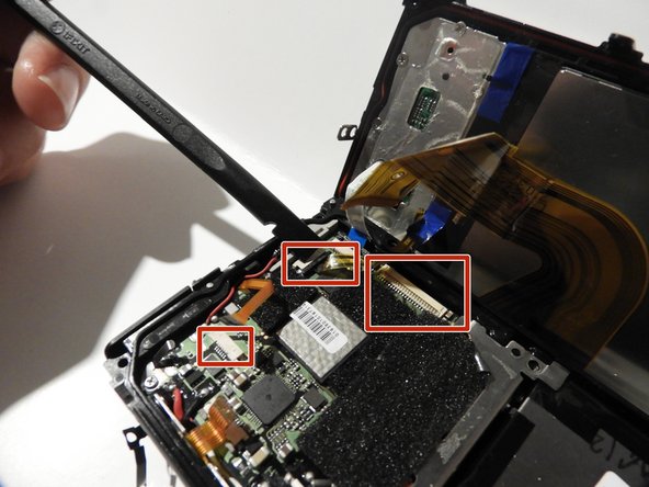

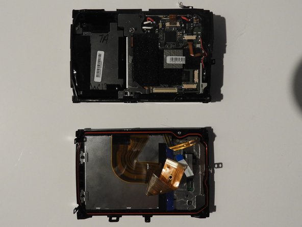

      • Release the top holding using a spudger.
      • Slowly and carefully separate the front and back of the camera, exposing the electrical ribbons.
    11. Olympus Stylus 1030 SW Camera Disassembly: crwdns2935265:011crwdnd2935265:01crwdnd2935265:03crwdne2935265:0 Olympus Stylus 1030 SW Camera Disassembly: crwdns2935265:011crwdnd2935265:02crwdnd2935265:03crwdne2935265:0 Olympus Stylus 1030 SW Camera Disassembly: crwdns2935265:011crwdnd2935265:03crwdnd2935265:03crwdne2935265:0
      • Using the spudger and tweezers if needed, remove the ribbons from the computer chips.
