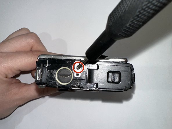

    • Use your screwdriver with a Phillips #00 screwdriver to remove all three screws.
    • Use your hand to lift and remove the front case.
  2. Olympus Stylus 1030 SW AV Port Replacement: crwdns2935265:02crwdnd2935265:01crwdnd2935265:03crwdne2935265:0 Olympus Stylus 1030 SW AV Port Replacement: crwdns2935265:02crwdnd2935265:02crwdnd2935265:03crwdne2935265:0 Olympus Stylus 1030 SW AV Port Replacement: crwdns2935265:02crwdnd2935265:03crwdnd2935265:03crwdne2935265:0
    • Remove the rear case.
    • Use a Phillips #00 screwdriver to remove both screws from the side panel.
    • Remove both screws from the battery door.

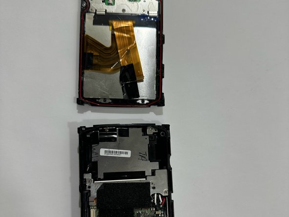

  3. Olympus Stylus 1030 SW AV Port Replacement: crwdns2935265:03crwdnd2935265:01crwdnd2935265:01crwdne2935265:0
    • Flip the Olympus Stylus 1030 SW camera upside down, the rear side facing away from you.

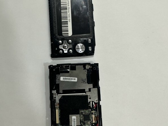

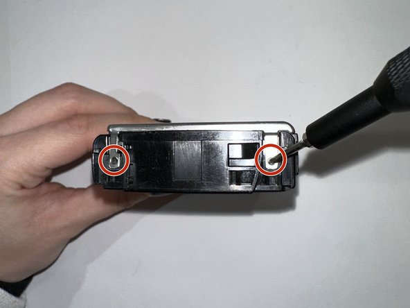

  4. Olympus Stylus 1030 SW AV Port Replacement: crwdns2935265:04crwdnd2935265:01crwdnd2935265:02crwdne2935265:0 Olympus Stylus 1030 SW AV Port Replacement: crwdns2935265:04crwdnd2935265:02crwdnd2935265:02crwdne2935265:0
    • Flip your camera with the rear side facing away from you. Take your screw driver with the #00 size to remove both screws.
    • Remove the front case.
  5. Olympus Stylus 1030 SW AV Port Replacement: crwdns2935265:05crwdnd2935265:01crwdnd2935265:03crwdne2935265:0 Olympus Stylus 1030 SW AV Port Replacement: crwdns2935265:05crwdnd2935265:02crwdnd2935265:03crwdne2935265:0 Olympus Stylus 1030 SW AV Port Replacement: crwdns2935265:05crwdnd2935265:03crwdnd2935265:03crwdne2935265:0
    • Start with the rear end facing away from you.
    • Use a Phillips #00 size to remove both screws.

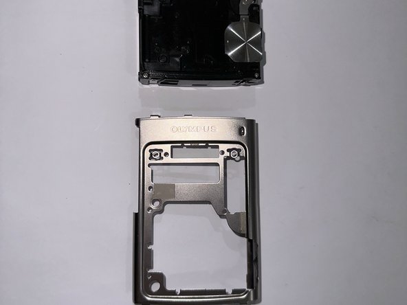

  6. Olympus Stylus 1030 SW AV Port Replacement: crwdns2935265:06crwdnd2935265:01crwdnd2935265:03crwdne2935265:0 Olympus Stylus 1030 SW AV Port Replacement: crwdns2935265:06crwdnd2935265:02crwdnd2935265:03crwdne2935265:0 Olympus Stylus 1030 SW AV Port Replacement: crwdns2935265:06crwdnd2935265:03crwdnd2935265:03crwdne2935265:0
    • To get to the AV port use a spudger to separate the camera.

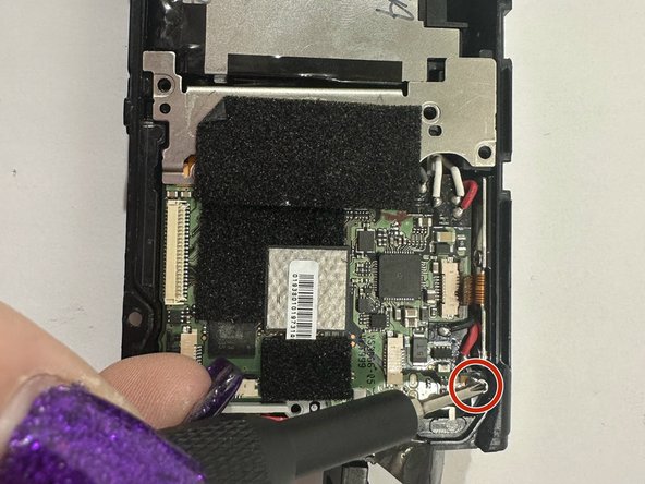

  7. Olympus Stylus 1030 SW AV Port Replacement: crwdns2935265:07crwdnd2935265:01crwdnd2935265:02crwdne2935265:0 Olympus Stylus 1030 SW AV Port Replacement: crwdns2935265:07crwdnd2935265:02crwdnd2935265:02crwdne2935265:0
    • Use a Phillips #00 screwdriver to remove the remaining two screws from the motherboard.

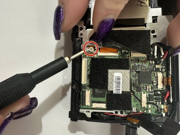

  8. Olympus Stylus 1030 SW AV Port Replacement: crwdns2935265:08crwdnd2935265:01crwdnd2935265:02crwdne2935265:0 Olympus Stylus 1030 SW AV Port Replacement: crwdns2935265:08crwdnd2935265:02crwdnd2935265:02crwdne2935265:0
    • Use your fingers to lift the black flap and use a Phillips #00 screwdriver to remove the two screws.

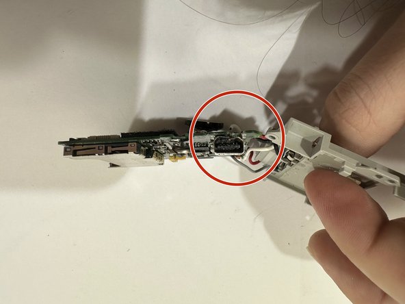

  9. Olympus Stylus 1030 SW AV Port Replacement: crwdns2935265:09crwdnd2935265:01crwdnd2935265:02crwdne2935265:0 Olympus Stylus 1030 SW AV Port Replacement: crwdns2935265:09crwdnd2935265:02crwdnd2935265:02crwdne2935265:0
    • With your tweezers from your kit, take out the motherboard of the camera.
    • Once the motherboard is removed separate the motherboard.
    • The AV port is visible, use your spatula to wedge between the AV port to remove.
