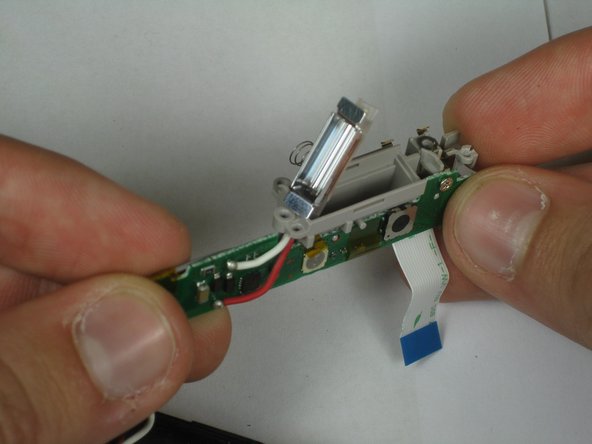

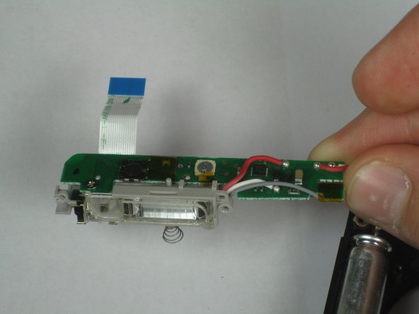

  18. Olympus Stylus 1010 Flash Replacement: crwdns2935265:018crwdnd2935265:01crwdnd2935265:03crwdne2935265:0 Olympus Stylus 1010 Flash Replacement: crwdns2935265:018crwdnd2935265:02crwdnd2935265:03crwdne2935265:0 Olympus Stylus 1010 Flash Replacement: crwdns2935265:018crwdnd2935265:03crwdnd2935265:03crwdne2935265:0
    • Remove the plastic flash cover using a spudger.
  19. Olympus Stylus 1010 Flash Replacement: crwdns2935265:019crwdnd2935265:01crwdnd2935265:02crwdne2935265:0 Olympus Stylus 1010 Flash Replacement: crwdns2935265:019crwdnd2935265:02crwdnd2935265:02crwdne2935265:0
    • Remove the flash bulb using a plastic spudger.
Curtis Reedy
