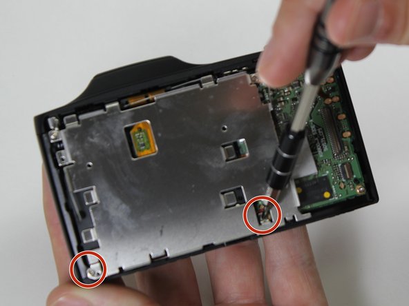

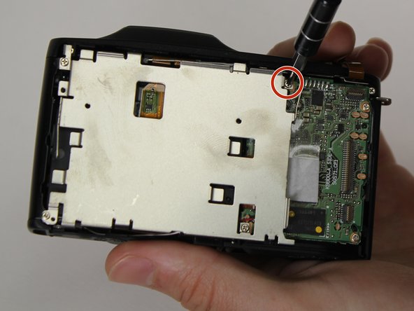

    1. Olympus SZ-12 Lens Replacement, Lens: crwdns2935265:010crwdnd2935265:01crwdnd2935265:02crwdne2935265:0 Olympus SZ-12 Lens Replacement, Lens: crwdns2935265:010crwdnd2935265:02crwdnd2935265:02crwdne2935265:0
      • Remove the four 3.8mm Phillips #000 screws from the LCD frame.
    2. Olympus SZ-12 Lens Replacement: crwdns2935265:011crwdnd2935265:01crwdnd2935265:03crwdne2935265:0 Olympus SZ-12 Lens Replacement: crwdns2935265:011crwdnd2935265:02crwdnd2935265:03crwdne2935265:0 Olympus SZ-12 Lens Replacement: crwdns2935265:011crwdnd2935265:03crwdnd2935265:03crwdne2935265:0
      • Remove the top left screw, top right screw, bottom left screw, and bottom right screw from LCD frame.
    3. Olympus SZ-12 Lens Replacement: crwdns2935265:012crwdnd2935265:01crwdnd2935265:03crwdne2935265:0 Olympus SZ-12 Lens Replacement: crwdns2935265:012crwdnd2935265:02crwdnd2935265:03crwdne2935265:0 Olympus SZ-12 Lens Replacement: crwdns2935265:012crwdnd2935265:03crwdnd2935265:03crwdne2935265:0
      • Lift the retaining flaps on the three remaining ZIF connectors connected to the motherboard.
    4. Olympus SZ-12 Lens Replacement: crwdns2935265:013crwdnd2935265:01crwdnd2935265:01crwdne2935265:0
      • Remove the five 4.3mm Phillips #000 screws from the lens frame to access the lens.
      • Remove the lens frame.
    5. Olympus SZ-12 Lens Replacement: crwdns2935265:014crwdnd2935265:01crwdnd2935265:03crwdne2935265:0 Olympus SZ-12 Lens Replacement: crwdns2935265:014crwdnd2935265:02crwdnd2935265:03crwdne2935265:0 Olympus SZ-12 Lens Replacement: crwdns2935265:014crwdnd2935265:03crwdnd2935265:03crwdne2935265:0
      • Remove two 4.3mm Phillips #000 screws from black plastic piece surrounding the lens.
      • Remove the lens.
