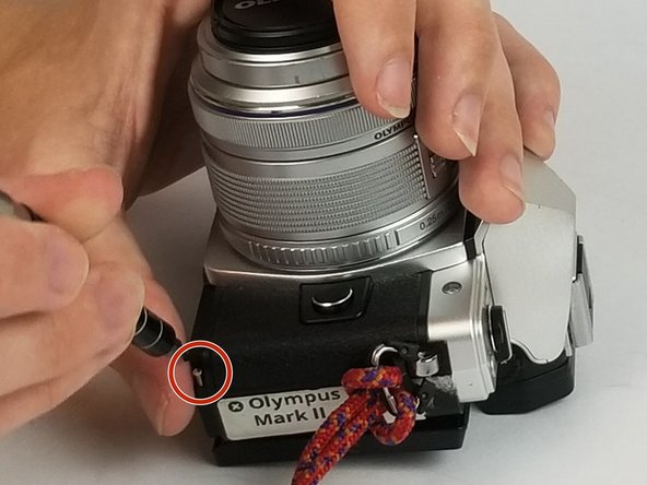

    • There are three different types and lengths of screws used to hold the bottom plate of the camera. Make proper note of each screws original position during your disassembly.
    • Using the PH00 Phillips-head screwdriver, unscrew the two 1/3 inch screws with silver threads from the the bottom of the camera.
    • Using the PH00 Phillips-head screwdriver, unscrew the three 1/3 inch screws with blue threads from the the bottom of the camera.
    • Using the PH00 Phillips-head screwdriver, unscrew the three 1/2 inch screws with silver threads from the the bottom of the camera.
