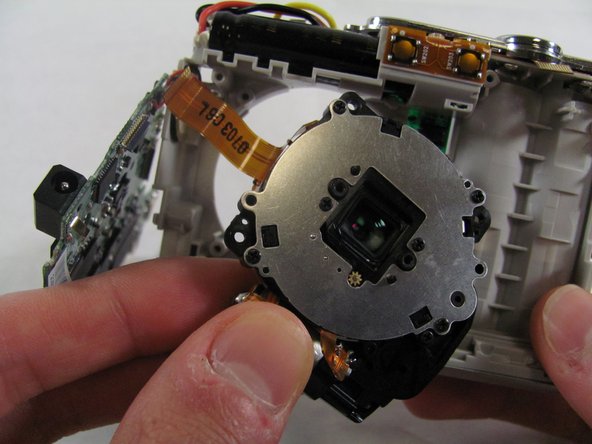

    1. Olympus FE-210 Lens Assembly Replacement, Lens Assembly: crwdns2935265:013crwdnd2935265:01crwdnd2935265:01crwdne2935265:0
      • Remove the three 3.6 mm screws using a #00 screwdriver.
    2. Olympus FE-210 Lens Assembly Replacement: crwdns2935265:014crwdnd2935265:01crwdnd2935265:02crwdne2935265:0 Olympus FE-210 Lens Assembly Replacement: crwdns2935265:014crwdnd2935265:02crwdnd2935265:02crwdne2935265:0
      • Slide the lens to the left and pull up. The lens should easily come loose and slide right out.
