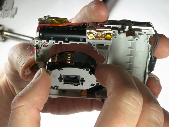

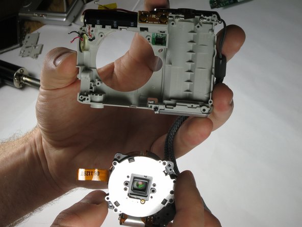

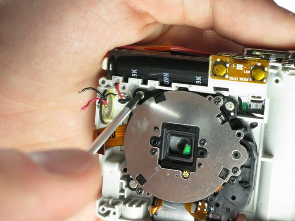

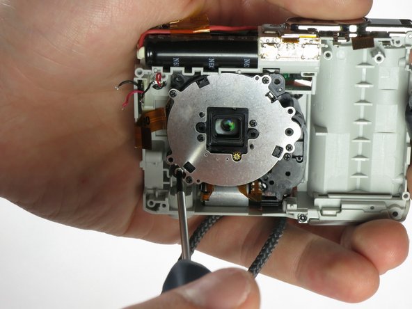

    1. Olympus FE-170 Lens Replacement, Lens: crwdns2935265:017crwdnd2935265:01crwdnd2935265:03crwdne2935265:0 Olympus FE-170 Lens Replacement, Lens: crwdns2935265:017crwdnd2935265:02crwdnd2935265:03crwdne2935265:0 Olympus FE-170 Lens Replacement, Lens: crwdns2935265:017crwdnd2935265:03crwdnd2935265:03crwdne2935265:0
      • Remove the 3 screws holding the lens assembly in place.
    2. Olympus FE-170 Lens Replacement: crwdns2935265:018crwdnd2935265:01crwdnd2935265:03crwdne2935265:0 Olympus FE-170 Lens Replacement: crwdns2935265:018crwdnd2935265:02crwdnd2935265:03crwdne2935265:0 Olympus FE-170 Lens Replacement: crwdns2935265:018crwdnd2935265:03crwdnd2935265:03crwdne2935265:0
      • Gently remove the lens assembly by pulling on the top of the assembly first, then removing from the device.
