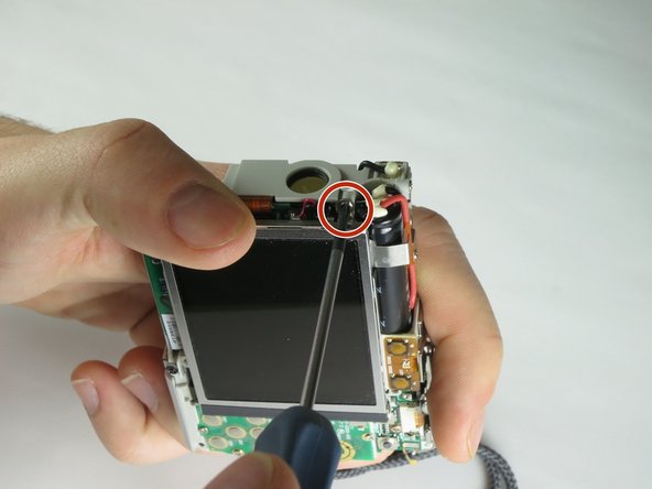

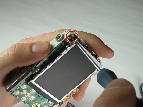

    1. Olympus FE-170 LCD Screen Replacement, LCD Screen: crwdns2935265:09crwdnd2935265:01crwdnd2935265:03crwdne2935265:0 Olympus FE-170 LCD Screen Replacement, LCD Screen: crwdns2935265:09crwdnd2935265:02crwdnd2935265:03crwdne2935265:0 Olympus FE-170 LCD Screen Replacement, LCD Screen: crwdns2935265:09crwdnd2935265:03crwdnd2935265:03crwdne2935265:0
      • Remove the three screws holding the LCD Screen in place.
      • The screws are located at the upper right, upper left, and lower left corners of the screen, as shown in the pictures.
      • After removing the screws, do not let the screen drop away or try to pull it out. It is still connected by a ribbon of wires.

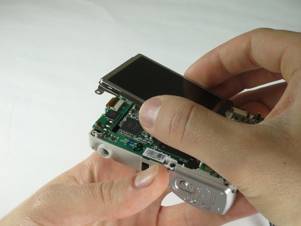

    2. Olympus FE-170 LCD Screen Replacement: crwdns2935265:010crwdnd2935265:01crwdnd2935265:03crwdne2935265:0 Olympus FE-170 LCD Screen Replacement: crwdns2935265:010crwdnd2935265:02crwdnd2935265:03crwdne2935265:0 Olympus FE-170 LCD Screen Replacement: crwdns2935265:010crwdnd2935265:03crwdnd2935265:03crwdne2935265:0
      • Carefully lift the LCD screen away
      • Don't pull away. The ribbon will still be connected to the camera.

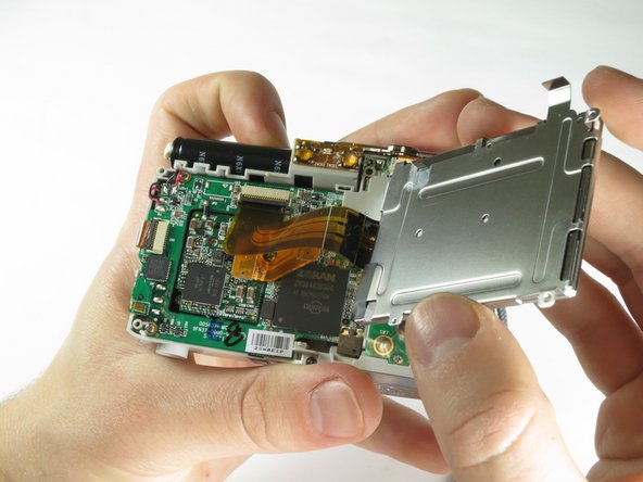

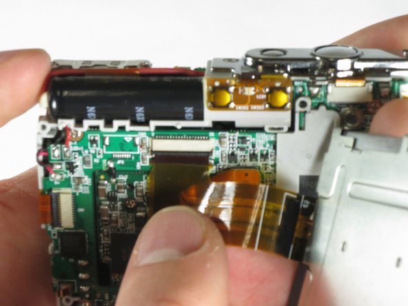

    3. Olympus FE-170 LCD Screen Replacement: crwdns2935265:011crwdnd2935265:01crwdnd2935265:02crwdne2935265:0 Olympus FE-170 LCD Screen Replacement: crwdns2935265:011crwdnd2935265:02crwdnd2935265:02crwdne2935265:0
      • Using a plastic opening tool, lift the latch on the ribbon connector.
      • Insert the plastic opening tool beneath the latch, and gently pull up.
      • Carefully pull the ribbon out, and lift the LCD screen out and away.
