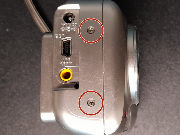

  2. Olympus FE-115 Case removal, Screws: crwdns2935265:02crwdnd2935265:01crwdnd2935265:01crwdne2935265:0
    • The case is held by 7 screws, as shown

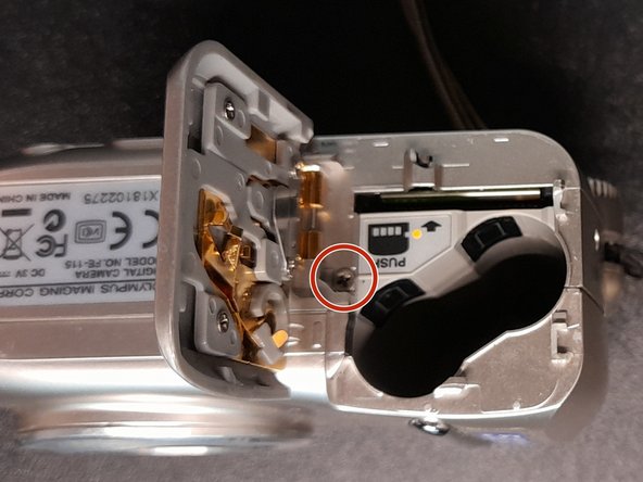

  3. Olympus FE-115 Case removal, Unscrew: crwdns2935265:03crwdnd2935265:01crwdnd2935265:03crwdne2935265:0 Olympus FE-115 Case removal, Unscrew: crwdns2935265:03crwdnd2935265:02crwdnd2935265:03crwdne2935265:0 Olympus FE-115 Case removal, Unscrew: crwdns2935265:03crwdnd2935265:03crwdnd2935265:03crwdne2935265:0
    • Unscrew all the screws
    • There is a hidden screw under the battery compartment

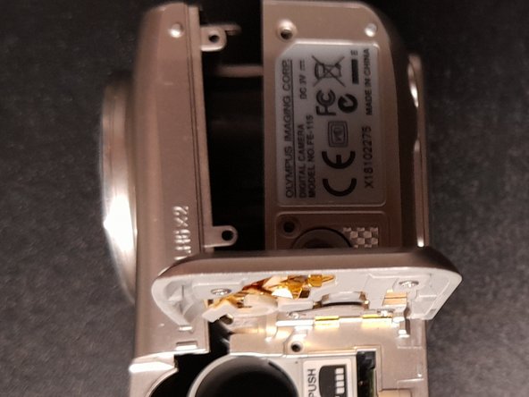

  4. Olympus FE-115 Case removal, Final removal: crwdns2935265:04crwdnd2935265:01crwdnd2935265:02crwdne2935265:0 Olympus FE-115 Case removal, Final removal: crwdns2935265:04crwdnd2935265:02crwdnd2935265:02crwdne2935265:0
    • After removing all the screws, gently pull apart the two pieces that form the exterior of the camera
    • Be careful to always keep the battery compartment completely open the whole time
