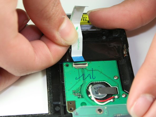

    • Using a spudger lift up the black retainer tab.
    • Avoid using metal pry tools, as shown in the photo, on internal electronic components, as it can cause a short and damage the device. Use an ESD-safe tool such as a standard nylon spudger.
    • Gently pull out the ribbon cable.

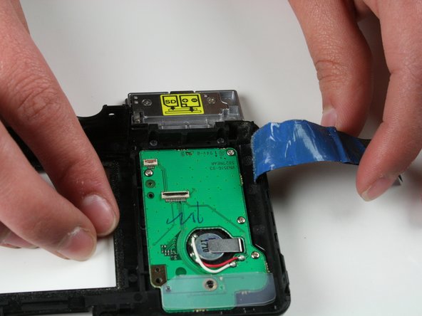

    • Using your fingers, grab the copper grounding strip and blue and black tape.
    • Pull these three back at the same time.
  13. Olympus E-Pl1 Speaker Replacement: crwdns2935265:013crwdnd2935265:01crwdnd2935265:02crwdne2935265:0 Olympus E-Pl1 Speaker Replacement: crwdns2935265:013crwdnd2935265:02crwdnd2935265:02crwdne2935265:0

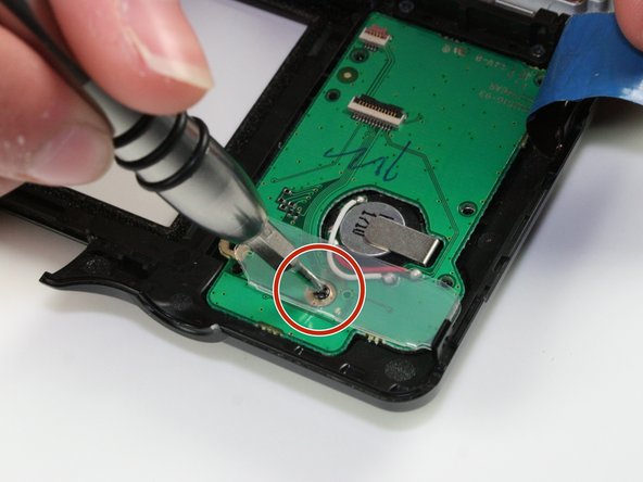

    • Using a #000 Phillips screwdriver remove the four 3.7 mm screws holding the board.
    • Using a #000 Phillips screwdriver remove the 4.3 mm screw as shown in picture two as well as the clear plastic sheet.
