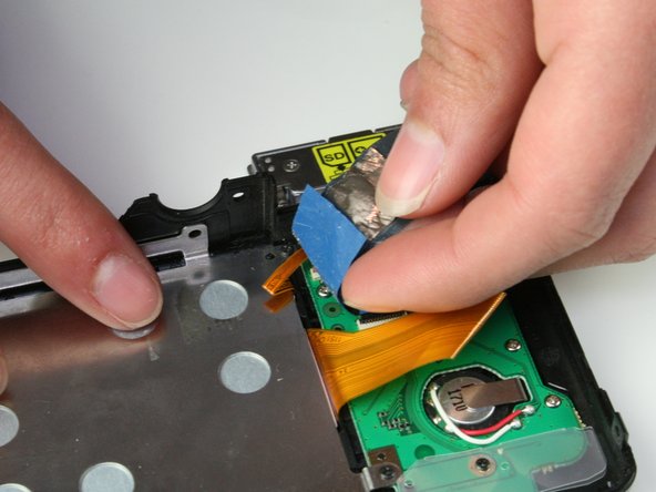

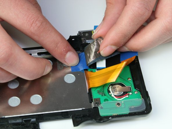

  6. Olympus E-PL1 LCD Screen Replacement, LCD Screen: crwdns2935265:06crwdnd2935265:01crwdnd2935265:03crwdne2935265:0 Olympus E-PL1 LCD Screen Replacement, LCD Screen: crwdns2935265:06crwdnd2935265:02crwdnd2935265:03crwdne2935265:0 Olympus E-PL1 LCD Screen Replacement, LCD Screen: crwdns2935265:06crwdnd2935265:03crwdnd2935265:03crwdne2935265:0
    • As per picture one: peel back the black strip.
    • As per picture two: peel back the Copper strip.
    • As per picture three: peel back the blue tape.

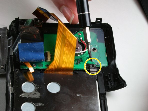

  7. Olympus E-PL1 LCD Screen Replacement: crwdns2935265:07crwdnd2935265:01crwdnd2935265:02crwdne2935265:0 Olympus E-PL1 LCD Screen Replacement: crwdns2935265:07crwdnd2935265:02crwdnd2935265:02crwdne2935265:0
    • There are four screws that need to be removed using the #000 Philips screwdriver.
    • Remove the three 3.4 mm screws on the silver panel.
    • Now remove the 4.3 mm screw located on the green board.

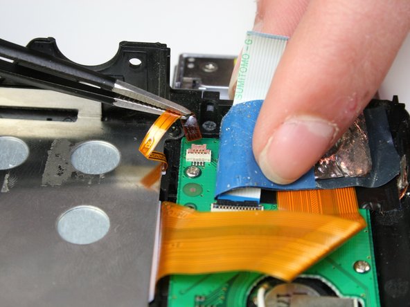

    • Use a spudger to lift the brown lock tab.
    • Avoid using metal pry tools, as shown in the photo, on internal electronic components, as it can cause a short and damage the device. Use an ESD-safe tool such as a standard nylon spudger.
    • Using tweezers, lift the ribbon cable from the brown lock tab.
  10. Olympus E-PL1 LCD Screen Replacement: crwdns2935265:010crwdnd2935265:01crwdnd2935265:01crwdne2935265:0
    • Lift out the LCD Screen.
