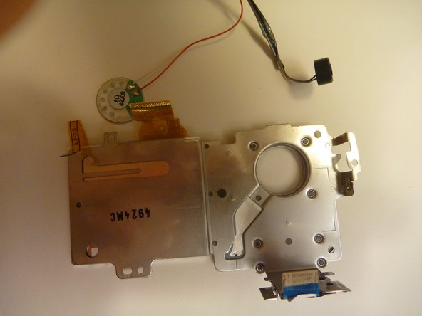

  17. Olympus D590 Speaker and Microphone Replacement: crwdns2935265:017crwdnd2935265:01crwdnd2935265:03crwdne2935265:0 Olympus D590 Speaker and Microphone Replacement: crwdns2935265:017crwdnd2935265:02crwdnd2935265:03crwdne2935265:0 Olympus D590 Speaker and Microphone Replacement: crwdns2935265:017crwdnd2935265:03crwdnd2935265:03crwdne2935265:0
    • View the front of the camera internal housing component.
    • Using tweezers, gently lift the speaker, cautiously maneuvering the wire away from the side of the internal housing component toward the front of the camera internal housing component.
  18. Olympus D590 Speaker and Microphone Replacement: crwdns2935265:018crwdnd2935265:01crwdnd2935265:02crwdne2935265:0 Olympus D590 Speaker and Microphone Replacement: crwdns2935265:018crwdnd2935265:02crwdnd2935265:02crwdne2935265:0
    • Gently lift the LCD screen away from the camera internal housing component hinging the thick yellow wiring tape attached to the camera internal housing component.
    • Use a forefinger and thumb to gently pull the thick yellow wiring tape out of the camera internal housing component.
  19. Olympus D590 Speaker and Microphone Replacement, Speaker and Microphone: crwdns2935265:019crwdnd2935265:01crwdnd2935265:01crwdne2935265:0
    • Using tweezers, gently lift and remove the clear tape covering the speaker.
  20. Olympus D590 Speaker and Microphone Replacement: crwdns2935265:020crwdnd2935265:01crwdnd2935265:02crwdne2935265:0 Olympus D590 Speaker and Microphone Replacement: crwdns2935265:020crwdnd2935265:02crwdnd2935265:02crwdne2935265:0
    • Gently lift the speaker from the LCD screen fitting.
