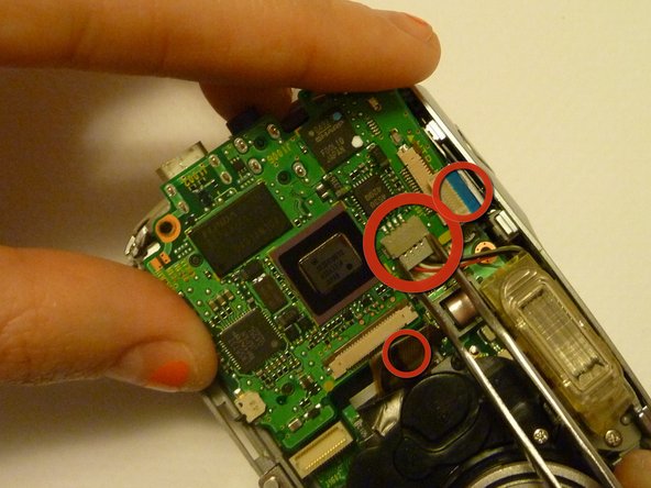

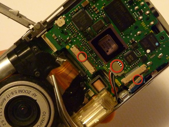

  10. Olympus D590 Motherboard Replacement: crwdns2935265:010crwdnd2935265:01crwdnd2935265:03crwdne2935265:0 Olympus D590 Motherboard Replacement: crwdns2935265:010crwdnd2935265:02crwdnd2935265:03crwdne2935265:0 Olympus D590 Motherboard Replacement: crwdns2935265:010crwdnd2935265:03crwdnd2935265:03crwdne2935265:0
    • Use rounded tweezers to disconnect the three wiring strips from the motherboard.
    • Using sharp tweezers may tear wiring tape and wires.
    • Use gentle force when wiggling or pulling wiring tape and wires to disconnect from the motherboard.
