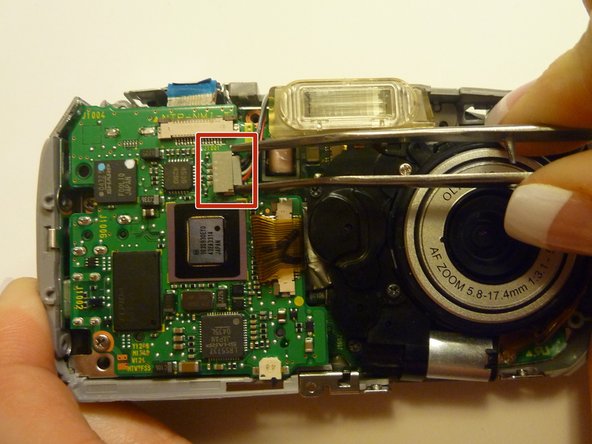

      • View the front of the camera internal housing component.
      • Using tweezers, detach the gray connector and blue wiring tape.
      • Be cautious to gently wiggle and pull blue wiring tape and gray wire connector during detachment.

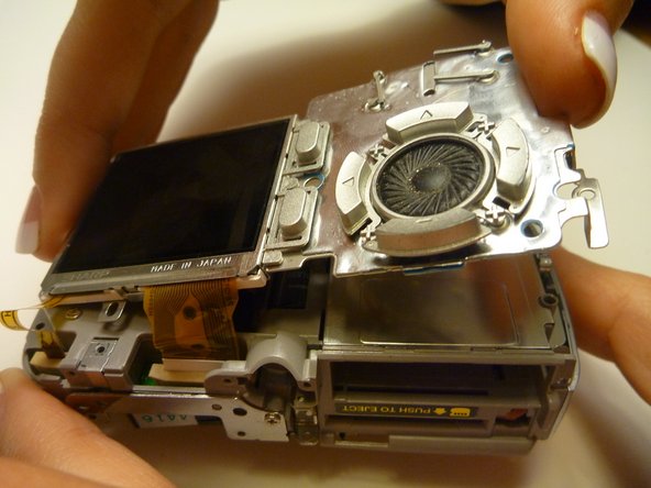

      • Using tweezers, gently lift the speaker, cautiously maneuvering the wire away from the side of the internal housing component toward the front of the camera internal housing component.
    7. Olympus D590 Lens Replacement: crwdns2935265:018crwdnd2935265:01crwdnd2935265:02crwdne2935265:0 Olympus D590 Lens Replacement: crwdns2935265:018crwdnd2935265:02crwdnd2935265:02crwdne2935265:0
      • Gently lift the LCD screen away from the camera internal housing component hinging the thick yellow wiring tape attached to the camera internal housing component.
      • Use a forefinger and thumb to gently pull the thick yellow wiring tape out of the camera internal housing component.

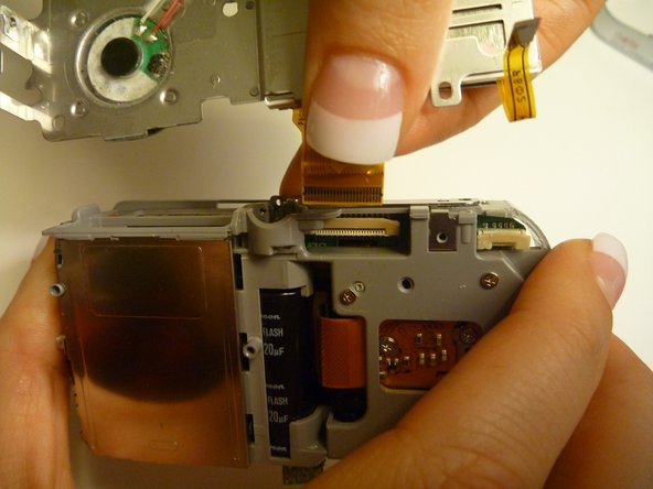

    1. Olympus D590 Lens Replacement, Lens: crwdns2935265:019crwdnd2935265:01crwdnd2935265:01crwdne2935265:0
      • Flip the camera so you are looking at the back.
      • Looking at the back of the camera, remove the 3 screws behind the camera lens.
    2. Olympus D590 Lens Replacement: crwdns2935265:020crwdnd2935265:01crwdnd2935265:01crwdne2935265:0
      • Flip the camera so that the front lens is facing up.
      • Disconnect the lens from the logic board.
    3. Olympus D590 Lens Replacement: crwdns2935265:021crwdnd2935265:01crwdnd2935265:01crwdne2935265:0
      • Flip the camera back over so that the back of the camera is facing you, and the lens in facing away.
      • Disconnect the wire that connects the logic board to the lens assembly.
      • Gently pull back on the wire to disconnect it safely.
