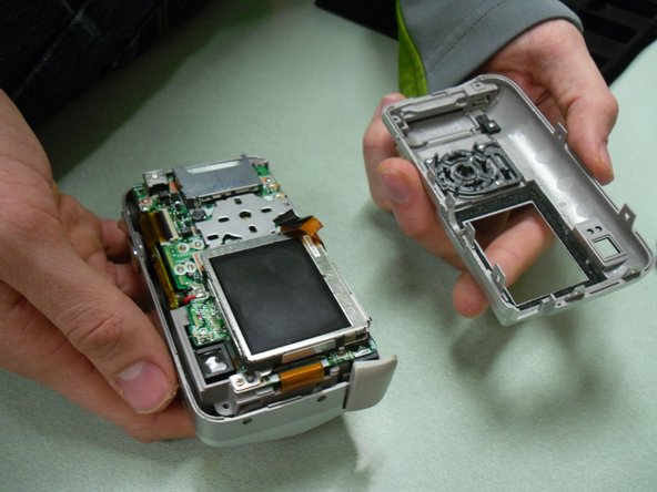

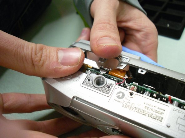

  3. Olympus Camedia D560 Rear Panel Control Buttons Replacement: crwdns2935265:03crwdnd2935265:01crwdnd2935265:03crwdne2935265:0 Olympus Camedia D560 Rear Panel Control Buttons Replacement: crwdns2935265:03crwdnd2935265:02crwdnd2935265:03crwdne2935265:0 Olympus Camedia D560 Rear Panel Control Buttons Replacement: crwdns2935265:03crwdnd2935265:03crwdnd2935265:03crwdne2935265:0
    • Use the blue opening tool to loosen and separate the back cover from the camera.

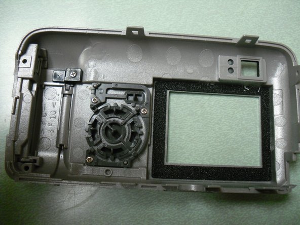

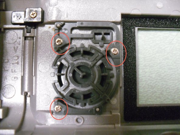

    • Locate and unscrew the three screws inside the back cover body (picture 3) .

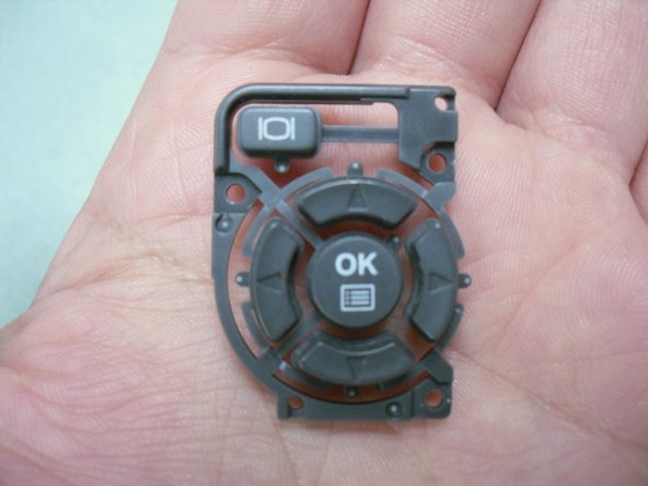

    • Remove button pad assembly from the back cover.
  5. Olympus Camedia D560 Rear Panel Control Buttons Replacement: crwdns2935265:05crwdnd2935265:01crwdnd2935265:03crwdne2935265:0 Olympus Camedia D560 Rear Panel Control Buttons Replacement: crwdns2935265:05crwdnd2935265:02crwdnd2935265:03crwdne2935265:0 Olympus Camedia D560 Rear Panel Control Buttons Replacement: crwdns2935265:05crwdnd2935265:03crwdnd2935265:03crwdne2935265:0
    • The button assembly is now separate from the back cover.
    • Inspect for broken areas. Replace or clean the button parts.
