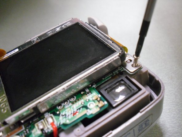

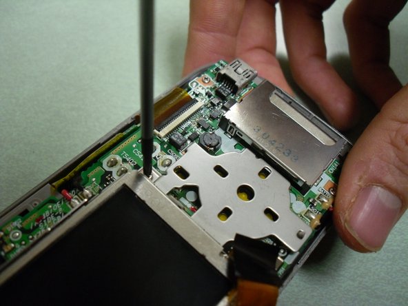

    • With the back plate off, locate two screws: one diagonal from the top left of the LCD screen and one diagonal from the top right of the LCD screen.
    • Unscrew both of these screws.

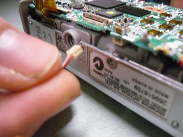

    • Unclip the plug attached to the red and white wires that connects the LCD screen to the motherboard.
