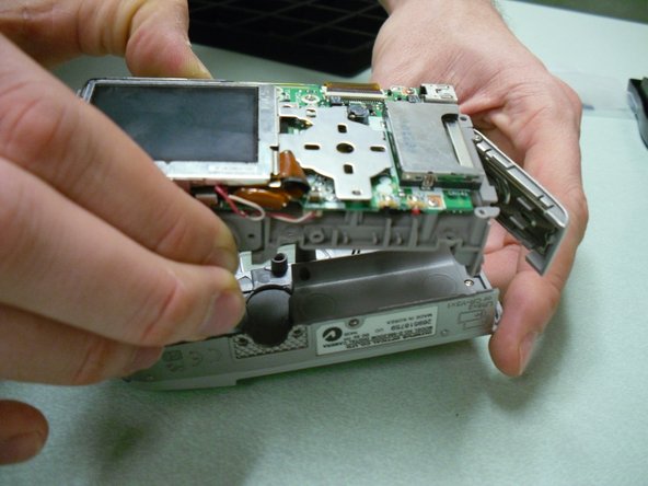

    • Remove all five screws found on the outer shell of the camera.
    • Three along the bottom
    • Two on the side closest to the LCD screen
    • You will find three more under the USB port flap and one more under the memory card flap. Remove these four as well.
    • Once all screws are removed, use a blue prying tool to carefully pry the back outer shell away from the rest of the camera.
  2. Olympus Camedia D560 Battery Compartment Cover Replacement: crwdns2935265:02crwdnd2935265:01crwdnd2935265:03crwdne2935265:0 Olympus Camedia D560 Battery Compartment Cover Replacement: crwdns2935265:02crwdnd2935265:02crwdnd2935265:03crwdne2935265:0 Olympus Camedia D560 Battery Compartment Cover Replacement: crwdns2935265:02crwdnd2935265:03crwdnd2935265:03crwdne2935265:0
    • Completely separate the back cover from the rest of the camera. Set the back cover aside.
    • Remove four screws from the front outer cover of the camera.
    • Use a Spudger to pry the front outer cover away from the camera. Do this gently to avoid damaging the yellow and black wires connecting the front outer cover to the camera.
  3. Olympus Camedia D560 Battery Compartment Cover Replacement: crwdns2935265:03crwdnd2935265:01crwdnd2935265:03crwdne2935265:0 Olympus Camedia D560 Battery Compartment Cover Replacement: crwdns2935265:03crwdnd2935265:02crwdnd2935265:03crwdne2935265:0 Olympus Camedia D560 Battery Compartment Cover Replacement: crwdns2935265:03crwdnd2935265:03crwdnd2935265:03crwdne2935265:0
    • To remove the yellow and black wires, gently unplug the end of the wire connected to the inner casing of the camera.
    • The front outer cover should now be completely separated from the rest of the camera.
  4. Olympus Camedia D560 Battery Compartment Cover Replacement: crwdns2935265:04crwdnd2935265:01crwdnd2935265:03crwdne2935265:0 Olympus Camedia D560 Battery Compartment Cover Replacement: crwdns2935265:04crwdnd2935265:02crwdnd2935265:03crwdne2935265:0 Olympus Camedia D560 Battery Compartment Cover Replacement: crwdns2935265:04crwdnd2935265:03crwdnd2935265:03crwdne2935265:0
    • Carefully set aside the front outer cover of the camera.
    • Locate and remove the two screws attaching the battery compartment cover to the rest of the camera.
    • Once both screws are removed, the back hinge of the battery compartment cover will flip up.
  5. Olympus Camedia D560 Battery Compartment Cover Replacement: crwdns2935265:05crwdnd2935265:01crwdnd2935265:01crwdne2935265:0
    • Your battery compartment cover should now be completely removed and ready for repair or replacement.
