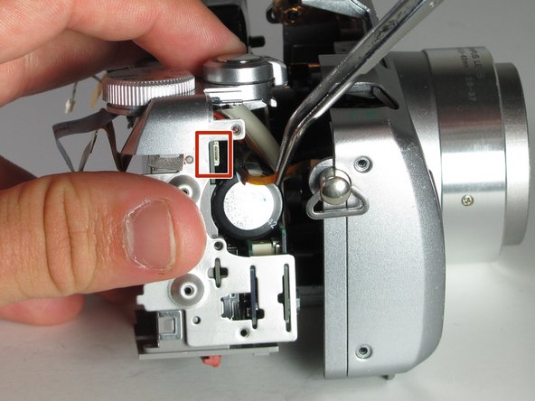

      • Remove the ribbon cable directly below the viewfinder.
      • Detach the white plastic clip from its socket with a pair of tweezers.
      • Disconnect the ribbon cable from the center of the board, near the central hole.
      • Disconnect the three ribbon cables from the top right of the motherboard, near the selector wheel. One is on the top of the board, and the other two are on the underside.

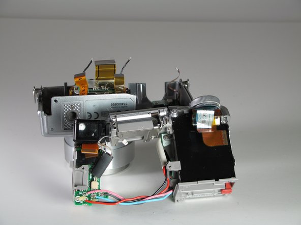

      • Use the soldering iron to desolder the connections from the motherboard.
      • For more information on desoldering, look here.
      • When soldering, avoid touching any of the other components with the soldering iron to prevent damage to the motherboard.
    7. Olympus C-765 Status LED Replacement: crwdns2935265:07crwdnd2935265:01crwdnd2935265:01crwdne2935265:0
      • Remove the motherboard from the camera.

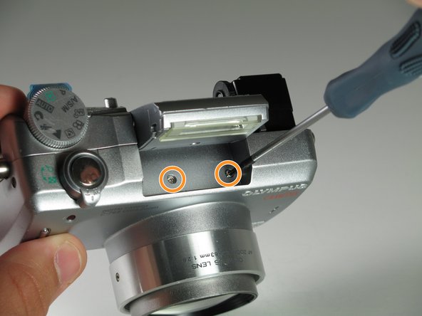

      • Remove the two 3 mm screws from the right side of the casing using a Phillips #00 screwdriver.
      • Pop the flash up to get access to the two body screws underneath.
      • Remove the two 3mm screws from under the flash using a Phillips #00 screwdriver.

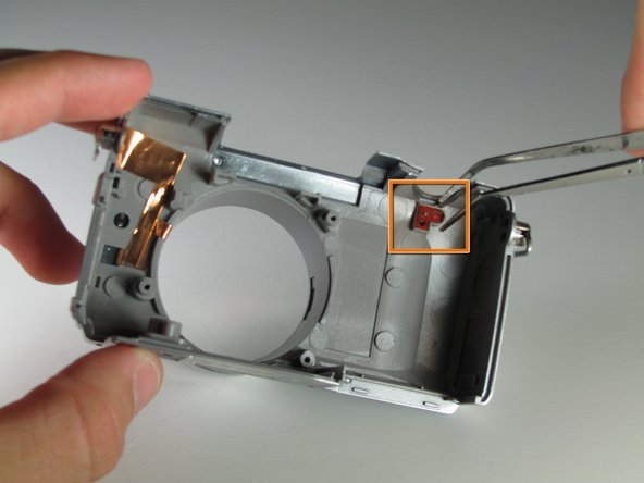

    3. Olympus C-765 Status LED Replacement: crwdns2935265:010crwdnd2935265:01crwdnd2935265:02crwdne2935265:0 Olympus C-765 Status LED Replacement: crwdns2935265:010crwdnd2935265:02crwdnd2935265:02crwdne2935265:0
      • Remove the LED circuit board.
      • Remove the single 3mm screw using a Phillips #00 screwdriver.
      • Use a pair of tweezers to remove the status LED board.
