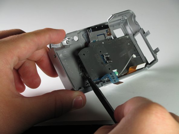

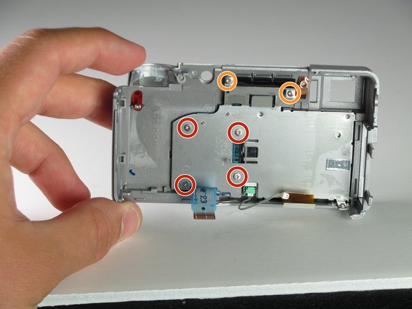

      • Peel the black tape off the back of the LCD.
      • Using the Phillips #00 remove the four 3mm screws on the LCD bracket.
      • Remove the two 2mm screws from the top of the bracket.
      • Use a spudger to pop the LCD screen out of the camera’s backplate.
      • When the bracket comes off, the buttons from the top section may fall out of place. If this happens then put them back in the position they were in.
