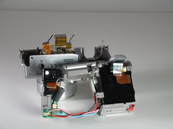

      • Remove the motherboard from the camera.

      • In order to access the flash assembly, you need to remove several interior components from the body of the camera.

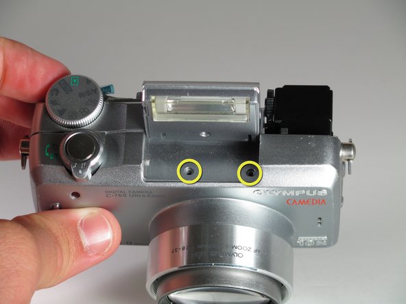

      • With a Phillips #00 screwdriver, unscrew the two 3mm screws from the right side of the casing.

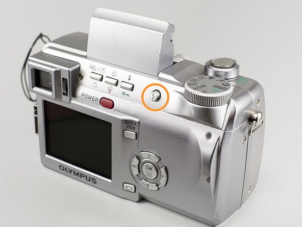

      • Raise the flash by pressing the shutter button or lifting the flash up with your fingers to access the two body screws underneath.
      • Using the Phillips #00 screwdriver, unscrew the two 3mm screws by twisting counterclockwise.

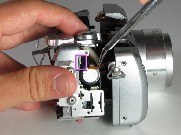

      • Gently pull the battery casing and the A/V ports away from the camera body to remove the connected components.
      • Using ESD Safe Blunt Nose Tweezers, gently remove the small ribbon cable from the right side of the casing
