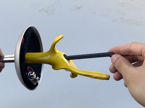

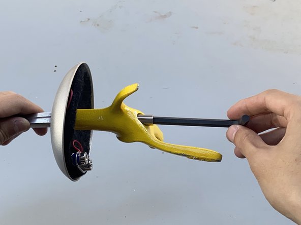

    • Remove the nut securing the handle with the 1 x 6 mm hex key.
  2. Olympic Fencing Foil Handguard Replacement: crwdns2935265:02crwdnd2935265:01crwdnd2935265:02crwdne2935265:0 Olympic Fencing Foil Handguard Replacement: crwdns2935265:02crwdnd2935265:02crwdnd2935265:02crwdne2935265:0
    • Remove the grip and pad.
