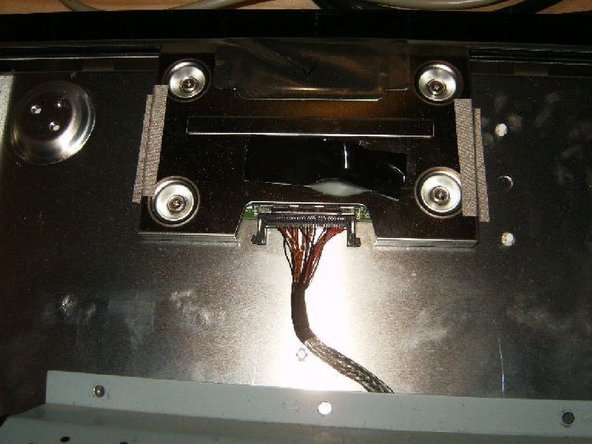

    • Once the back is unscrewed it can be separated. It is only pressed to the front part slightly and should come off pretty easy. There is now a grey metal box that holds the printed circuit boards.
    • At the top left and right, are two sets of cables that enter the metal box.Those are the speaker wires. Unclip the connectors.

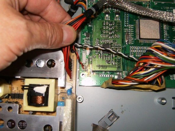

    • Once you tilt it, you will see a wiring harness that is connected to the box via some tabs. Pull those gently apart, remove the shielded cable.
    • The harness is terminated via a connector to the side. Unplug the connector by GENTLY pulling on the side of the plastic. Do not pull on the wires.
  6. Olevia LT23HVX Power supply repair: crwdns2935265:06crwdnd2935265:01crwdnd2935265:02crwdne2935265:0 Olevia LT23HVX Power supply repair: crwdns2935265:06crwdnd2935265:02crwdnd2935265:02crwdne2935265:0
    • The next wiring to remove terminates to the top to another connector. This one is a little trickier and must be removed by squeezing the tabs on the side while pulling the connector.
    • In my case, do to a broken clip on the side of this connector I opted to leave it connected. That way, I can not totally remove the metal cover, but will have to turn it over.

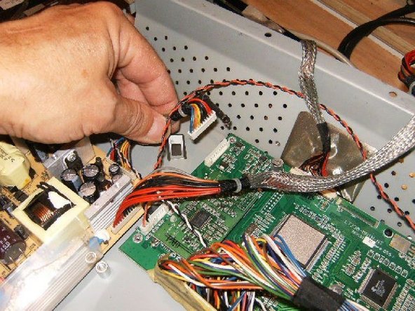

    • Once the wiring harnesses are disconnected and they are off the metal tabs, tilt the metal cover to the left. Check continously that all the wires are off and nothing gets hung up.
  7. Olevia LT23HVX Power supply repair: crwdns2935265:07crwdnd2935265:01crwdnd2935265:03crwdne2935265:0 Olevia LT23HVX Power supply repair: crwdns2935265:07crwdnd2935265:02crwdnd2935265:03crwdne2935265:0 Olevia LT23HVX Power supply repair: crwdns2935265:07crwdnd2935265:03crwdnd2935265:03crwdne2935265:0

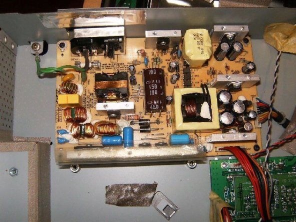

    • You should now be looking at the PCB's The power board is the one that has the switch on it, as well as two heatsinks.
    • Remove the wiring harness on the top right side.
    • Remove the connector from the inverter board, as well as the ground wire.
    • Remove the green cable from the power board to the housing.
    • Remove the connector from the top right and top side. They will only fit one way. No reason to mark the location.

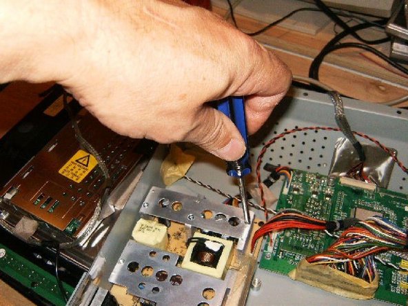

    • The two heatsinks can be removed either now or later.
  8. Olevia LT23HVX Power supply repair: crwdns2935265:08crwdnd2935265:01crwdnd2935265:03crwdne2935265:0 Olevia LT23HVX Power supply repair: crwdns2935265:08crwdnd2935265:02crwdnd2935265:03crwdne2935265:0 Olevia LT23HVX Power supply repair: crwdns2935265:08crwdnd2935265:03crwdnd2935265:03crwdne2935265:0

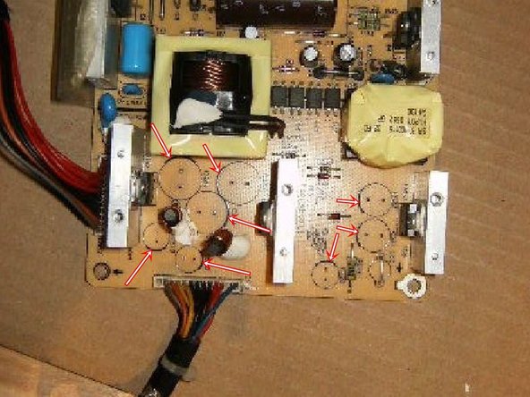

    • Once all wiring harnesses are remove, and the green ground cable is off the chassis, remove the powerboard. It is held in place with four small screws, one on each corner.
    • The power board should now be disconnected from the monitor. On the side furthest ways from the switch, is a transformer. Next to it, there are a total of 7 condensers and 3 heatsinks. It is those condensers that are failing due to heat.

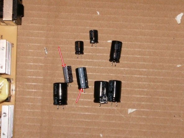

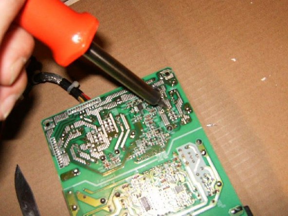

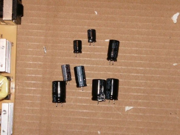

    • Take a closer look at the tops of the condensers (here is the view of one that was removed) The tops are most likely bulging on at least 5 of them. Plan to replace all 7 on that side.
    • Unsolder the condensers from the board. In this repair a 30watt soldering iron and solder sucker was used. The solder sucker can be substituted with soldering wick.
  10. Olevia LT23HVX Power supply repair: crwdns2935265:010crwdnd2935265:01crwdnd2935265:02crwdne2935265:0 Olevia LT23HVX Power supply repair: crwdns2935265:010crwdnd2935265:02crwdnd2935265:02crwdne2935265:0
    • This is what the board looks like with the faulty condensers removed.
    • Here are the faulty condensers. Replace those with new ones. For this repair, new ones where obtained through Mouser..com.
    • CS19 = 220uF 35V CS20 = 220UF 25V CS21 = 1000uF 16V CS22 = 1000uF 16V CS23 = 1000uF 25V CS24 = 680uF 35V CS25 = 680uF 35V All are radial lead electrolytic capacitors.
