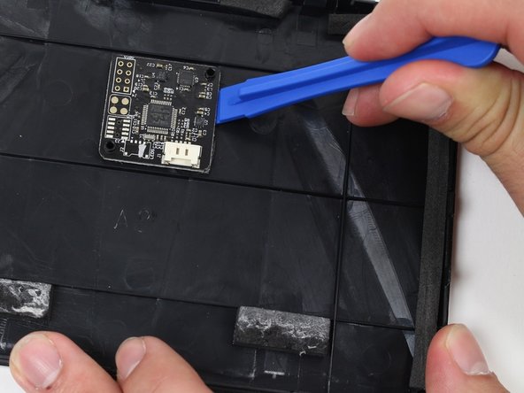

  7. Oculus Rift Tracker V2 Board Replacement, Oculus Tracker V2 Board: crwdns2935265:07crwdnd2935265:01crwdnd2935265:01crwdne2935265:0
    • Remove wires from the Tracker V2 Board using your fingernail or a plastic opening tool.
  8. Oculus Rift Tracker V2 Board Replacement: crwdns2935265:08crwdnd2935265:01crwdnd2935265:03crwdne2935265:0 Oculus Rift Tracker V2 Board Replacement: crwdns2935265:08crwdnd2935265:02crwdnd2935265:03crwdne2935265:0 Oculus Rift Tracker V2 Board Replacement: crwdns2935265:08crwdnd2935265:03crwdnd2935265:03crwdne2935265:0
    • On the front cover of the Oculus Headset, locate the Tracker V2 Board.
    • Using the Plastic Opening Tool, pry the board from the adhesive. You will need to lift from both sides of the board.
