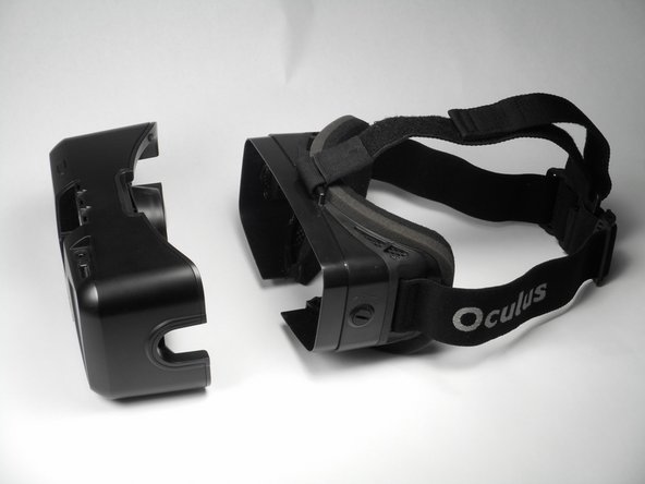

    • Remove front cover plate.
    • Unplug the USB and HDMI cables from the Oculus Rift DK2.
  2. Oculus Rift Development Kit 2 Headset Motherboard Replacement: crwdns2935265:02crwdnd2935265:01crwdnd2935265:03crwdne2935265:0 Oculus Rift Development Kit 2 Headset Motherboard Replacement: crwdns2935265:02crwdnd2935265:02crwdnd2935265:03crwdne2935265:0 Oculus Rift Development Kit 2 Headset Motherboard Replacement: crwdns2935265:02crwdnd2935265:03crwdnd2935265:03crwdne2935265:0
    • Remove the four 3/8" Phillips #0 screws from the inner portion of the headset.
  3. Oculus Rift Development Kit 2 Headset Motherboard Replacement: crwdns2935265:03crwdnd2935265:01crwdnd2935265:02crwdne2935265:0 Oculus Rift Development Kit 2 Headset Motherboard Replacement: crwdns2935265:03crwdnd2935265:02crwdnd2935265:02crwdne2935265:0
    • With the screws removed, gently pull the headband frame apart from the headset.

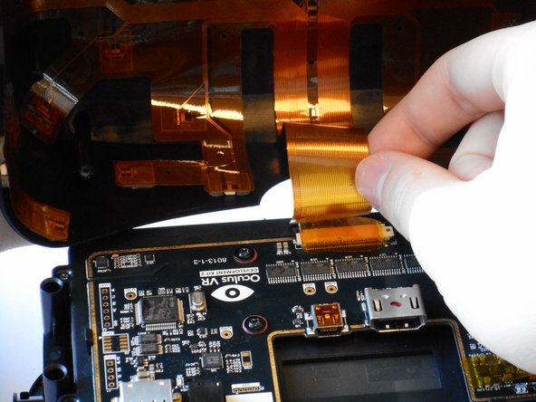

  8. Oculus Rift Development Kit 2 Headset Motherboard Replacement: crwdns2935265:08crwdnd2935265:01crwdnd2935265:02crwdne2935265:0 Oculus Rift Development Kit 2 Headset Motherboard Replacement: crwdns2935265:08crwdnd2935265:02crwdnd2935265:02crwdne2935265:0
    • Gently pull out the small side tabs on the ribbon cable connector as shown to release the cable.
    • Push the tabs away from you, with the headset oriented as pictured. Carefully slide the ribbon cable out.
    • The headset should now be two separate pieces.

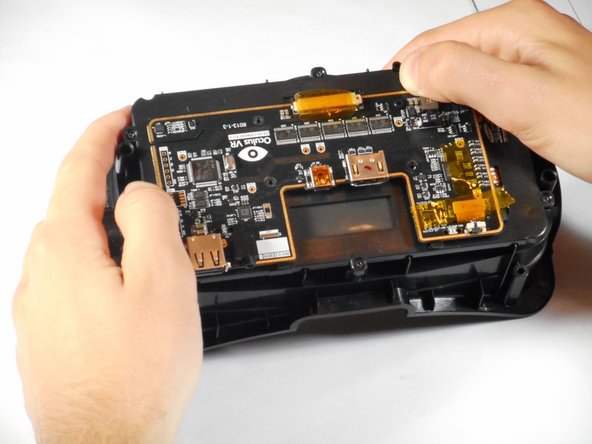

  9. Oculus Rift Development Kit 2 Headset Motherboard Replacement: crwdns2935265:09crwdnd2935265:01crwdnd2935265:03crwdne2935265:0 Oculus Rift Development Kit 2 Headset Motherboard Replacement: crwdns2935265:09crwdnd2935265:02crwdnd2935265:03crwdne2935265:0 Oculus Rift Development Kit 2 Headset Motherboard Replacement: crwdns2935265:09crwdnd2935265:03crwdnd2935265:03crwdne2935265:0
    • Unscrew the three 1/4" Phillips #00 screws as pictured and use the tweezers to lift them out.

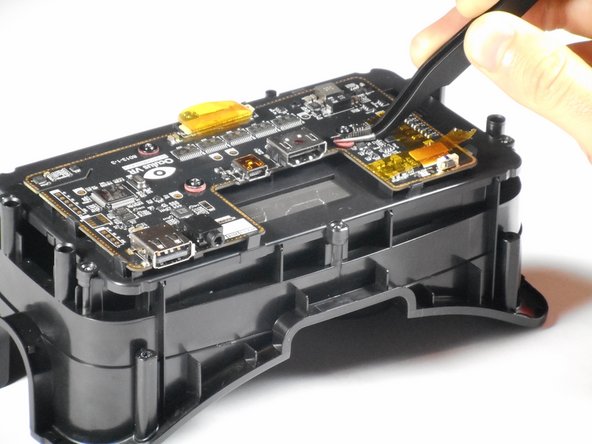

  10. Oculus Rift Development Kit 2 Headset Motherboard Replacement: crwdns2935265:010crwdnd2935265:01crwdnd2935265:01crwdne2935265:0
    • Lift the tape and gently pry up the video data ribbon cable using the plastic opening tool as shown.

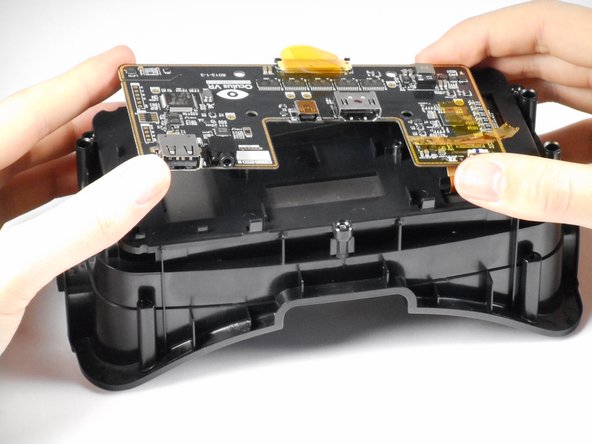

  11. Oculus Rift Development Kit 2 Headset Motherboard Replacement: crwdns2935265:011crwdnd2935265:01crwdnd2935265:03crwdne2935265:0 Oculus Rift Development Kit 2 Headset Motherboard Replacement: crwdns2935265:011crwdnd2935265:02crwdnd2935265:03crwdne2935265:0 Oculus Rift Development Kit 2 Headset Motherboard Replacement: crwdns2935265:011crwdnd2935265:03crwdnd2935265:03crwdne2935265:0
    • Gently pry back the motherboard clips to release the motherboard. The motherboard should now lift free.
