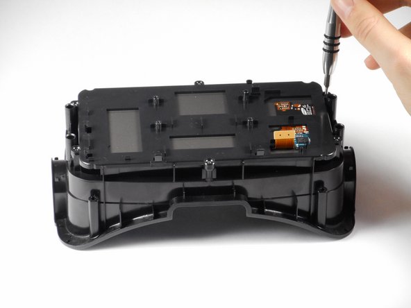

Oculus Rift Development Kit 2 Display Screen Replacement
If there are cracks or mars in the video display, the display screen may be broken.
    1. Oculus Rift Development Kit 2 Display Screen Replacement, Eye Relief Adjustment Screw: crwdns2935265:01crwdnd2935265:01crwdnd2935265:03crwdne2935265:0 Oculus Rift Development Kit 2 Display Screen Replacement, Eye Relief Adjustment Screw: crwdns2935265:01crwdnd2935265:02crwdnd2935265:03crwdne2935265:0 Oculus Rift Development Kit 2 Display Screen Replacement, Eye Relief Adjustment Screw: crwdns2935265:01crwdnd2935265:03crwdnd2935265:03crwdne2935265:0
      • Remove front cover plate.
      • Unplug the USB and HDMI cables from the Oculus Rift DK2.
    2. Oculus Rift Development Kit 2 Display Screen Replacement: crwdns2935265:02crwdnd2935265:01crwdnd2935265:03crwdne2935265:0 Oculus Rift Development Kit 2 Display Screen Replacement: crwdns2935265:02crwdnd2935265:02crwdnd2935265:03crwdne2935265:0 Oculus Rift Development Kit 2 Display Screen Replacement: crwdns2935265:02crwdnd2935265:03crwdnd2935265:03crwdne2935265:0
      • Remove the four 3/8" Phillips #0 screws from the inner portion of the headset.
    3. Oculus Rift Development Kit 2 Display Screen Replacement: crwdns2935265:03crwdnd2935265:01crwdnd2935265:02crwdne2935265:0 Oculus Rift Development Kit 2 Display Screen Replacement: crwdns2935265:03crwdnd2935265:02crwdnd2935265:02crwdne2935265:0
      • With the screws removed, gently pull the headband frame apart from the headset.
    1. Oculus Rift Development Kit 2 Display Screen Replacement, Remove Lens: crwdns2935265:04crwdnd2935265:01crwdnd2935265:02crwdne2935265:0 Oculus Rift Development Kit 2 Display Screen Replacement, Remove Lens: crwdns2935265:04crwdnd2935265:02crwdnd2935265:02crwdne2935265:0
      • With the Oculus facing up, twist the right lens clockwise and lift it out. Repeat for the left lens twisting counterclockwise instead.
    1. Oculus Rift Development Kit 2 Display Screen Replacement, Headset Motherboard: crwdns2935265:05crwdnd2935265:01crwdnd2935265:01crwdne2935265:0
      • Using tweezers, carefully lift the four rubber plugs as shown. They are a bit snug and you may need to jiggle them free with the tweezers.
    2. Oculus Rift Development Kit 2 Display Screen Replacement: crwdns2935265:06crwdnd2935265:01crwdnd2935265:01crwdne2935265:0
      • Remove the four 3/8" screws attaching the eyewear enclosure to the front casing.
      • Read the next step before removing the faceplate!
    3. Oculus Rift Development Kit 2 Display Screen Replacement: crwdns2935265:07crwdnd2935265:01crwdnd2935265:02crwdne2935265:0 Oculus Rift Development Kit 2 Display Screen Replacement: crwdns2935265:07crwdnd2935265:02crwdnd2935265:02crwdne2935265:0
      • Carefully separate the faceplate and the cover. Gently rest the cover plate on top of the faceplate as shown in the pictures.
      • Do not use excessive force when separating these two pieces. There is a delicate ribbon cable connected to each.
    4. Oculus Rift Development Kit 2 Display Screen Replacement: crwdns2935265:08crwdnd2935265:01crwdnd2935265:02crwdne2935265:0 Oculus Rift Development Kit 2 Display Screen Replacement: crwdns2935265:08crwdnd2935265:02crwdnd2935265:02crwdne2935265:0
      • Gently pull out the small side tabs on the ribbon cable connector as shown to release the cable.
      • Push the tabs away from you, with the headset oriented as pictured. Carefully slide the ribbon cable out.
      • The headset should now be two separate pieces.
    5. Oculus Rift Development Kit 2 Display Screen Replacement: crwdns2935265:09crwdnd2935265:01crwdnd2935265:03crwdne2935265:0 Oculus Rift Development Kit 2 Display Screen Replacement: crwdns2935265:09crwdnd2935265:02crwdnd2935265:03crwdne2935265:0 Oculus Rift Development Kit 2 Display Screen Replacement: crwdns2935265:09crwdnd2935265:03crwdnd2935265:03crwdne2935265:0
      • Unscrew the three 1/4" Phillips #00 screws as pictured and use the tweezers to lift them out.
    6. Oculus Rift Development Kit 2 Display Screen Replacement: crwdns2935265:010crwdnd2935265:01crwdnd2935265:01crwdne2935265:0
      • Lift the tape and gently pry up the video data ribbon cable using the plastic opening tool as shown.
    7. Oculus Rift Development Kit 2 Display Screen Replacement: crwdns2935265:011crwdnd2935265:01crwdnd2935265:03crwdne2935265:0 Oculus Rift Development Kit 2 Display Screen Replacement: crwdns2935265:011crwdnd2935265:02crwdnd2935265:03crwdne2935265:0 Oculus Rift Development Kit 2 Display Screen Replacement: crwdns2935265:011crwdnd2935265:03crwdnd2935265:03crwdne2935265:0
      • Gently pry back the motherboard clips to release the motherboard. The motherboard should now lift free.
    1. Oculus Rift Development Kit 2 Display Screen Replacement, Display Screen: crwdns2935265:012crwdnd2935265:01crwdnd2935265:03crwdne2935265:0 Oculus Rift Development Kit 2 Display Screen Replacement, Display Screen: crwdns2935265:012crwdnd2935265:02crwdnd2935265:03crwdne2935265:0 Oculus Rift Development Kit 2 Display Screen Replacement, Display Screen: crwdns2935265:012crwdnd2935265:03crwdnd2935265:03crwdne2935265:0
      • Remove the six 1/4" Phillips #1 screws as shown. There should be two on each short side, and one on each long side.
      • Gently lift the plastic screen holder and display screen away from the remaining piece of the faceplate.
