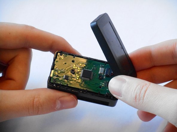

    • Remove the two 3/16" J #000 screws.
    • Lift the back plate off.

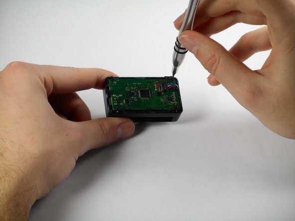

  4. Oculus Rift Development Kit 2 Camera Motherboard Replacement: crwdns2935265:04crwdnd2935265:01crwdnd2935265:01crwdne2935265:0
    • Gently tug on the wires to free them from the motherboard.

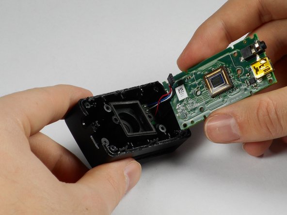

  5. Oculus Rift Development Kit 2 Camera Motherboard Replacement: crwdns2935265:05crwdnd2935265:01crwdnd2935265:03crwdne2935265:0 Oculus Rift Development Kit 2 Camera Motherboard Replacement: crwdns2935265:05crwdnd2935265:02crwdnd2935265:03crwdne2935265:0 Oculus Rift Development Kit 2 Camera Motherboard Replacement: crwdns2935265:05crwdnd2935265:03crwdnd2935265:03crwdne2935265:0
    • Remove the four 3/16" Phillips #000 from the four corners of the motherboard.
    • Remove the two 1/4" Phillips #0 screws shown to release the motherboard from the enclosure.
