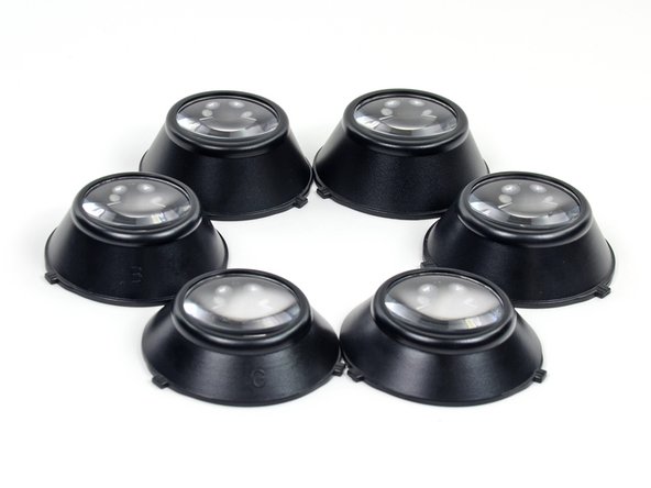

    • Apparently we have to choose either A cups, B cups, or C cups for our eyes. Then we have to measure our IPD (inter-pupillary distance), and put TF2 into VR mode.

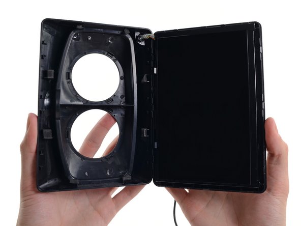

    • So far, so good. Let's see how easily we can access the display!
    • Two frame pieces are held together with clips, easily freed with a plastic opening tool.
    • With the lens cowling removed, we get our first unobstructed look at the 1280x800 LCD.
  7. Oculus Rift DK1 Teardown: crwdns2935265:08crwdnd2935265:01crwdnd2935265:03crwdne2935265:0 Oculus Rift DK1 Teardown: crwdns2935265:08crwdnd2935265:02crwdnd2935265:03crwdne2935265:0 Oculus Rift DK1 Teardown: crwdns2935265:08crwdnd2935265:03crwdnd2935265:03crwdne2935265:0

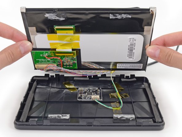

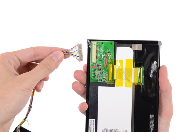

    • A couple of clips and some sticky foam adhesive hold the display securely into the front panel of the Oculus, ensuring a firm grip on the screen while you're whipping your head around in-game.
    • Disconnecting one cable from the display assembly allows us to completely remove it for further examination.
  8. Oculus Rift DK1 Teardown: crwdns2935265:09crwdnd2935265:01crwdnd2935265:02crwdne2935265:0 Oculus Rift DK1 Teardown: crwdns2935265:09crwdnd2935265:02crwdnd2935265:02crwdne2935265:0

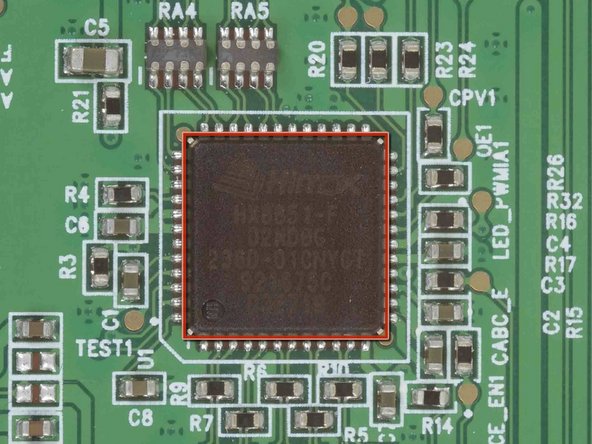

    • Great News! The Oculus uses an Innolux HJ070IA-02D 7" LCD.
    • Chimei Innolux is Taiwan's largest LCD manufacturer and is rumored to be a replacement source for Apple's iPad Mini screens.
    • The back of the LCD hosts a Himax HX8851 timing controller.

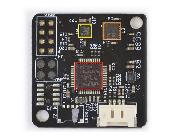

    • The final component out of the headset is the Oculus Tracker V2 board, custom designed and optimized for a 1000 Hz refresh rate.
    • Here we find the chips controlling the revolutionary head-tracking device:
    • STMicroelectronics 32F103C8 ARM Cortex-M3 microcontroller with 72 MHz CPU
    • Invensense MPU-6000 six-axis (gyro + accelerometer) motion tracking controller
    • Honeywell HMC5983 three-axis digital compass, probably used in conjunction with the accelerometer to correct for gyroscope drift
    • The back of the sensor board is covered in shiny contact points, presumably for easily testing each board in a spring contact rig.

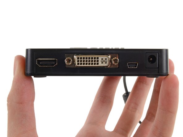

    • How does the Oculus Rift hook up to your PC, you ask? With the control box, of course.
    • Our Development Kit control box is a pretty basic device, consisting of buttons for adjusting the Rift's settings and a handful of I/O ports.
    • From left to right: HDMI, DVI, Mini USB, and DC-in.
    • Video input to the Oculus Rift is DVI, but the handy dandy control box is capable of converting your PC's HDMI output to DVI. VGA is not supported at this time.
