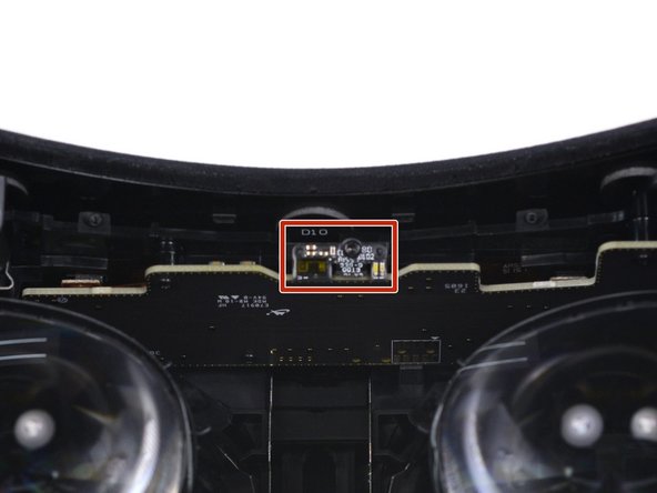

  8. Oculus Rift CV1 Teardown: crwdns2935265:08crwdnd2935265:01crwdnd2935265:02crwdne2935265:0 Oculus Rift CV1 Teardown: crwdns2935265:08crwdnd2935265:02crwdnd2935265:02crwdne2935265:0
    • Leaving the meat for the main course, let's take a peek at the salad LED array.
    • Those fiddly cables connect to a set of three IR LED arrays: Top, Bottom, and Strap heading up the rear.
    • Each LED is labeled, and D8 through D10 are hanging out near a lone "hidden" microphone. What's that for, we wonder.
    • Future features like in-game chat, voice commands, or ambient noise volume adjustment are good bets.
    • A MEMS microphone is found beneath the Kapton tape at the bottom of the case.

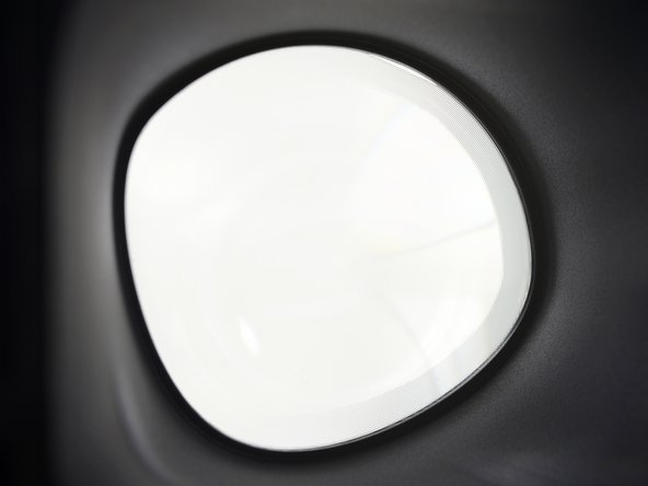

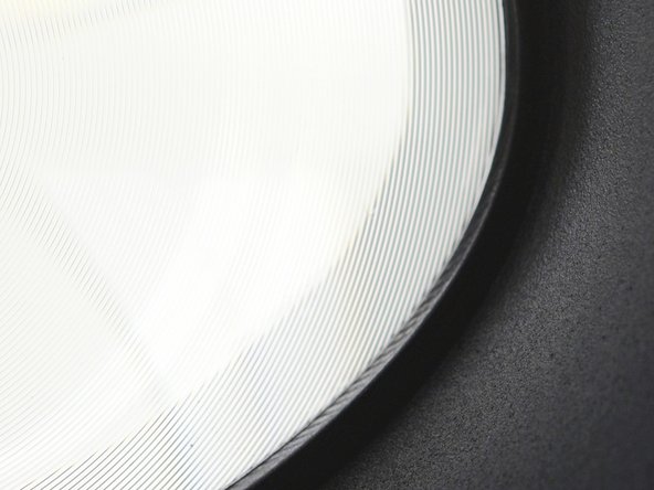

  12. Oculus Rift CV1 Teardown: crwdns2935265:012crwdnd2935265:01crwdnd2935265:03crwdne2935265:0 Oculus Rift CV1 Teardown: crwdns2935265:012crwdnd2935265:02crwdnd2935265:03crwdne2935265:0 Oculus Rift CV1 Teardown: crwdns2935265:012crwdnd2935265:03crwdnd2935265:03crwdne2935265:0
    • Where prior Oculus Rift kits shipped with interchangeable circular lenses (left), the CV1 uses a single set of non-removable, asymmetric lenses (right).
    • A closeup of the CV1 lens reveals these concentric rings, a telltale sign of Fresnel lenses. These cleverly manufactured lenses do the same job as the thick, bulging, curved plastic lenses seen in prior Rifts—using thin arrays of concentric prisms that weigh far less.
    • The Fresnel lens yields the same large viewing angle and short focal length, but with a fraction of the material—which is exactly what VR needs. It all has to go into a brick-sized device you can strap to your face for hours, without putting a strain on your poor neck muscles.
    • Bonus round: by varying the size and shape of the concentric prisms, Oculus was able to fine-tune the lens for this specific application, minimizing spherical aberrations (or distortions) that may result from a traditional curved lens. This probably explains the asymmetric shape.
  13. Oculus Rift CV1 Teardown: crwdns2935265:013crwdnd2935265:01crwdnd2935265:01crwdne2935265:0
    • But wait—if Fresnel lenses do away with the bulging curves of traditional lenses, why are these lenses curved?
    • Turns out, Oculus went a step further down the optical tunnel, and manufactured hybrid Fresnel lenses.
    • These lenses are made up of concentric prisms of uniform thickness (like any other Fresnel lens). But an extra, sloping layer is added to the back of the lens, creating a shape that mimics a traditional curved lens—and allowing the focus to vary along the vertical axis of the lens.
    • That's why the Rift instructs you to focus the headset by simply pushing it higher or lower on your face. Look through a different part of the lens until you find the focus suited to your eyes. Bingo, no more three-sets-of-lenses Rifts.

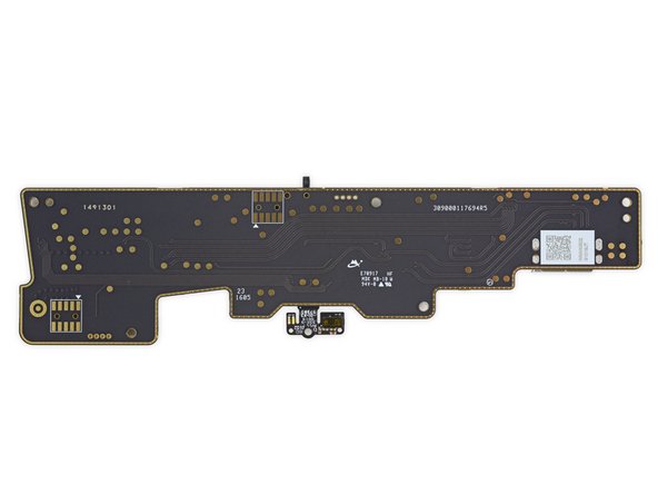

    • Next to come out is the LED driver board, featuring all the labels a teardowner/reassemblist could want...
  15. Oculus Rift CV1 Teardown: crwdns2935265:016crwdnd2935265:01crwdnd2935265:02crwdne2935265:0 Oculus Rift CV1 Teardown: crwdns2935265:016crwdnd2935265:02crwdnd2935265:02crwdne2935265:0
    • The aforementioned well-labeled board, complete with over a dozen test points and the essential control hardware.
    • Unlike the STMicroelectronics LED drivers we found in the Development Kit 2, this IC array hails from Texas Instruments:
    • 3x Texas Instruments TLC59401 16-Channel LED Driver with Dot Correction and Grayscale PWM Control
    • On the reverse, we see a pair of (relatively) large capacitors—probably necessary to smooth the intermittent load of pulsing such a huge array of IR LEDs.
