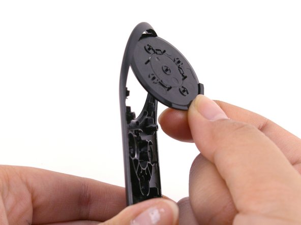

  5. Oculus Rift CV1 Remote Button Replacement: crwdns2935265:05crwdnd2935265:01crwdnd2935265:02crwdne2935265:0 Oculus Rift CV1 Remote Button Replacement: crwdns2935265:05crwdnd2935265:02crwdnd2935265:02crwdne2935265:0
    • Gently peel off the top of the control board.
    • Be gentle, if the buttons fall off, try to keep them in the orientation that they were in.
    • If the large black button falls off, place it back into the shell by orienting the tabs on the button to match the holes on the shell.
  6. Oculus Rift CV1 Remote Button Replacement: crwdns2935265:06crwdnd2935265:01crwdnd2935265:01crwdne2935265:0
    • Pull the old buttons off and replace them with the new ones.
