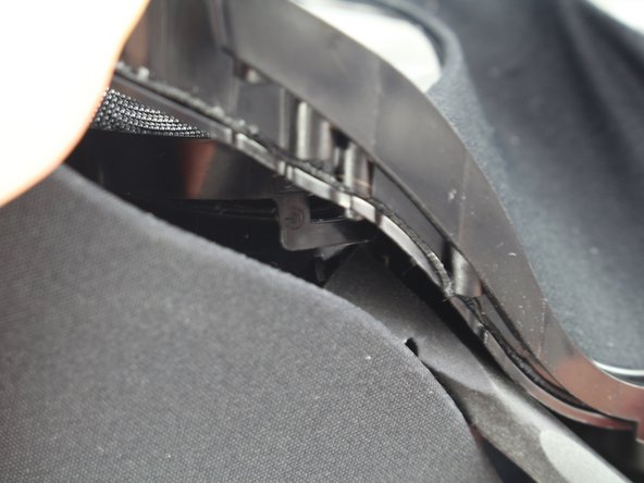

  4. Oculus Rift CV1 Lens Replacement: crwdns2935265:04crwdnd2935265:01crwdnd2935265:03crwdne2935265:0 Oculus Rift CV1 Lens Replacement: crwdns2935265:04crwdnd2935265:02crwdnd2935265:03crwdne2935265:0 Oculus Rift CV1 Lens Replacement: crwdns2935265:04crwdnd2935265:03crwdnd2935265:03crwdne2935265:0
    • Lift up the frame to see a tab hidden underneath the lycra mesh along the edge of the lens.
    • Pull up on the tab with the spudger.
    • Repeat for the corresponding tab on the other lens.
